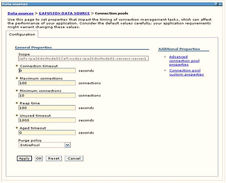

  1. Expand the Resources option in the LHS menu and click JDBC > Data sources option to display the Data sources window.
  2. Click the newly created Data Source $DATA_SOURCE$ and navigate to the path Data sources > GAFUSION DATA_SOURCE > Connection pools.
    Figure 11-21 Connection Pools
    Connection Pools
  3. Set the following values:
    1. Connection timeout: 0
    2. Maximum connections: 100
    3. Minimum connections: 10
    You can also define Reap time, Unused timeout, and Aged timeout as required.
