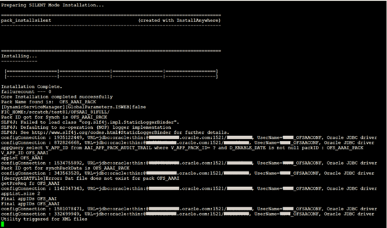

    Figure 9-1 OFS AAAI Silent Mode Installation
    Enter the silent command in the console to execute the application pack installer with the Silent option. The installer proceeds with the pre-installation checks and starts the upgrade installation process.
    Data Model Upload may take several hours to complete. You can check the installation logs in the following location: OFS_AAAI/OFS_AAAI/logs

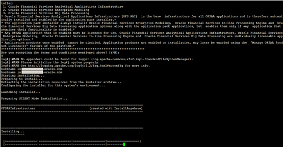

    Figure 9-2 Silent Mode Installation In Progress
    The OFSAA Infrastructure installation performs a post-install check automatically on the successful installation of the product.
