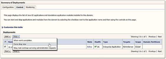

  3. From the Navigation Tree for Domain Structure, select Deployments to display the Summary of Deployments window.
    Figure 15-4 Summary of Deployments Window
    From the Navigation Tree for Domain Structure, select Deployments to display the Summary of Deployments window. Select the check box adjacent to the application that you want to uninstall, click Stop, and then select Force Stop Now.
  4. Select the check box adjacent to the application that you want to uninstall, click Stop, and then select Force Stop Now.
  5. Click Yes in the confirmation dialog to stop the selected deployment.

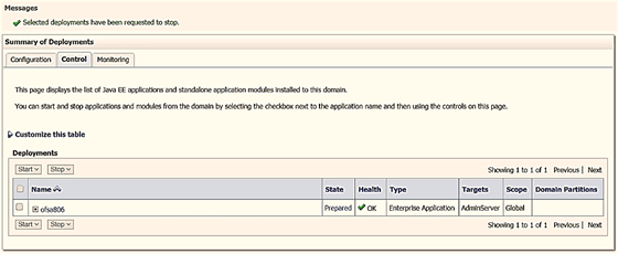

    Figure 15-5 Stop the Selected Deployment
    Once you click Yes in the confirmation dialog to stop the selected deployment the confirmation message is displayed.
