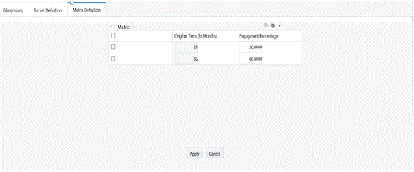

  9. Enter the Prepayment Rates in the Prepayment Model.
    Bucket values for the row and column dimensions are displayed as a table, while the bucket val­ues for the page dimensions (if selected) are shown in the drop down list.
    Figure 15-1 Manual Prepayment Model
    Repeat the process for all bucket values of the page driver. To change the bucket value along the page driver, select the required value from the drop-down list.
    Bucket values will be displayed in the drop-down list only if you selected three drivers.
  10. Click Apply. The Prepayment Rates are saved and the Prepayment Model Rule summary page is displayed.
