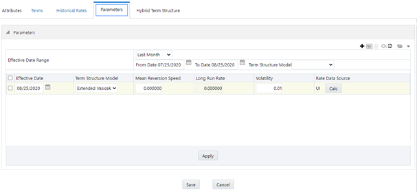

Figure 5-8 Parameters Tab on Interest Rate Code window
To edit or recalculate the existing Parameters, enter the Effective Date Range filter.

- Default parameters for the Extended Vasicek Model are
displayed for one Effective Date (the System Date on which the Interest Rate Code
was created). You can edit these parameters or add new parameters using
Add. Use the Refresh to return to
existing Parameters.
Steps 3 and 4 are applicable only if you are Adding or Editing Parameters.To add or edit the parameters, use the Data Input Helper or Excel Import or Export. For more information, see the Excel Import or Export and Data Loader sections.
- Enter the Effective Date. Note that the Effective Date cannot be greater than the Current System Date.
- Select the Model from the Term Structure Model drop-down list. Effective Date and Term Structure Model combination must be unique within this IRC.

Parameter Valid Range Default Value Volatility 0% to 500% 0.01 Mean reversion speed 0.00 to 500 0.0 Long run rate 0.00% to 500% 0.0 - The Rate Data Source indicates if you have directly entered Parameters through the UI. You can calculate the Parameters to display system-generated values.
- Select Calculate to view the Term Structures Parameter Estimation window.
- If you are directly entering the Parameters, then enter values appropriate to the Model, then click Apply else click Calculate.
