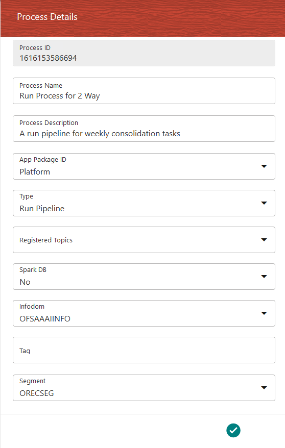

The following are the steps for creating a Run Pipeline:
  1. Seed AOM Data Fields. For more information, see Configuring Application Object Model (AOM) section.
  2. Click the Add icon in the Process Modeller Summary window.
    Figure 5-5 Process Details Window to Create a Run Pipeline
    This image displays the Process Details Window to Create a Run Pipeline.
  3. Enter a Process Name and a description. The Process ID is a system-generated unique value.
  4. Select the appropriate app package in which you want to create the process. For more information, see the Application Package section.
  5. Select Run Pipeline from the Type drop-down list.
  6. If you have selected Run Pipeline, set the Process Execution On Failure:
    • Yes–Select Yesto execute the process, even when the process fails.
    • No-(Default). Select Noto stop the process execution, during a process failure.
    This step is applicable while you create sub-run pipelines also.
  7. Select the information domain in which you want to create the Run Process, from the Infodom drop-down list. The list displays all the Infodoms that are mapped to the applications configured in your OFSAA instance.
  8. Click the Accept icon to save it. The Process Flow canvas is displayed.
  9. By default, the START icon from the toolbar appears. This Start activity indicates the beginning of the Process.
