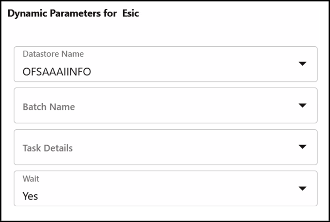

In the Process Flow window, click the ESICicon in Widgetfrom the toolbar and drag and drop it onto the canvas. Double-click the widget to display the Activity window.
Figure 8-7 Dynamic Parameters for ESIC
Table 8-6 Dynamic Parameters for ESIC Description
| FieldName | Description |
| Datastore Name | Refers to the name of the Information Domain. By default, the Information Domain to which you are connected is selected. |
| Batch Name | Lists all the batches associated with the selected Datastore. Select the required Batch from the drop-down list, for execution. |
| Task Details |
Liststhe tasks associated with the selected Batch. You can either execute one task or all the tasks associated with the selected batch
| Wait | If enabled (set to Yes), execution waits for the ESIC component to finish task execution and then update the task status. |
