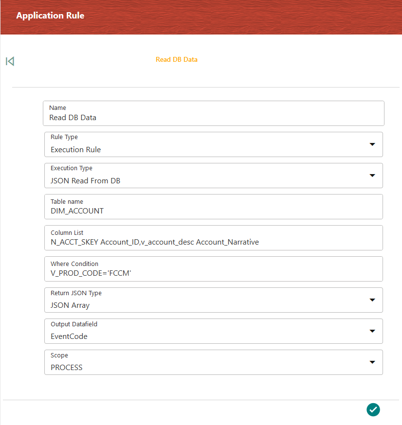

JSON Read From DB Application Rule
This Application Rule is used to read data from the database in JSON format.
Figure 4-18 JSON Read from DB Rule Details window
Table 4-14 JSON Read from DB Rule Details Description
| Field Name | Description |
| Name | Enter a unique name for the Application Rule. |
| Rule Type | Only the Execution Rule type is supported. |
| Execution Type | Displays the Execution Type as JSON Read From DB. |
| Table Name | Enter the table name from which you want to read the data. |
| Column List | Enter the column names of the selected table. |
| Where Condition | Enter the filter condition (where clause) of the SQL query. |
| Return JSON Type |
Select the JSON type of the returned value as JSON Object or JSON Array based on your requirement.
| Output DataField | Select the DataField to which you want to return the value of the SQL query, from the drop-down list. |
| Scope |
Select the scope of the Application Rule from the drop-down list. The options are:
