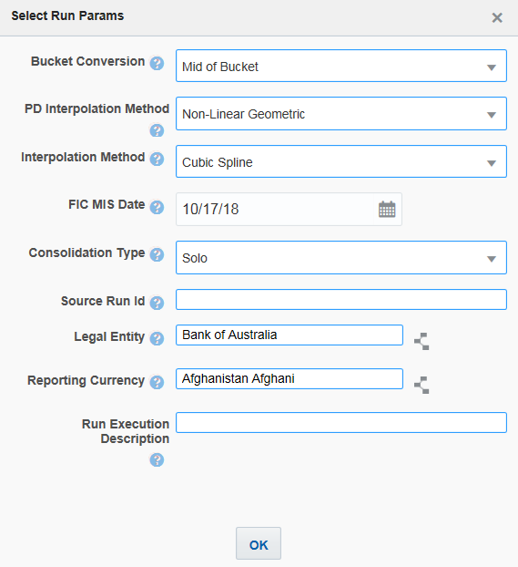

  2. Click Execute Run to execute the Pipeline. The Select Run Params window is displayed.
    Figure 5-9 Select Run Params window
    This image displays the Select Run Params window.
  3. Select values for the Run Parameters and click OK.
The execution of the Pipeline is triggered using the selected FIC MIS DATE. The RUNSKEY is generated and inserted into the “DIM_RUN” table. For the RUNSKEY generated, the corresponding user-selected parameters are inserted into the “RUN_EXE_PARAMETERS” table.
