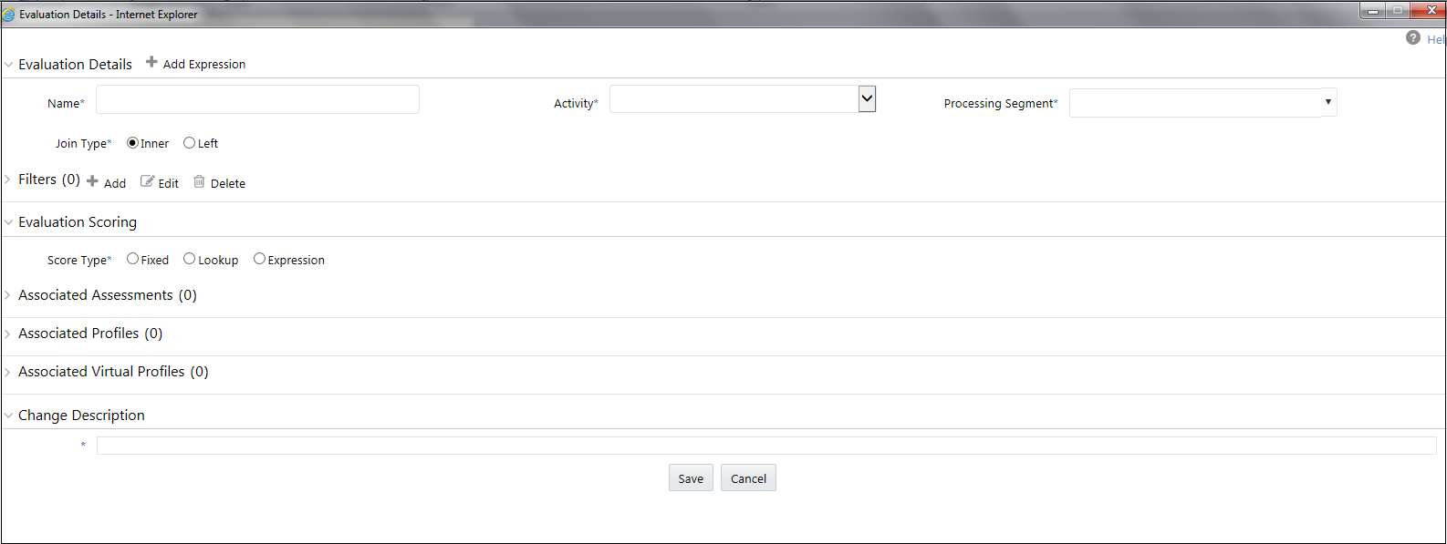

  1. Navigate to the Evaluation details page.
  2. Click Add on the Evaluations tool bar. The Add Evaluation page is displayed.
    Figure 10-2 Adding an Evaluation
  3. Enter the following details:
    • Name: Enter the name of the evaluation.
    • Processing Segment: Select the processing segment from the drop-down list.
    • Activity: Select the activity from the drop-down list.
    • Join Type: Select the type of Join from the drop-down list:
      • Inner : This option performs the intersection of records between two tables and gives a FAIL for no intersection.
        This is the default option.
      • Left: This option lists the records between two tables which are based on a particular condition and gives a NULL for no transaction.
  4. Click Save. A confirmation message is displayed.
