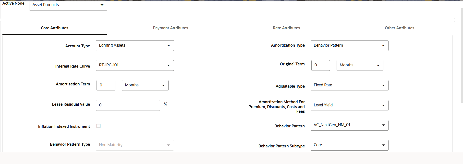

3.10.4.1 Core Attributes
This section describes the new business fields used in the Core Attributes tab of the Product Characteristics Rule.
Figure 3-33 Core Attributes Tab to Define the Product Characteristic Rule
Table 3-29 Fields to add the Core Attributes for Product Characteristic Rule and their Descriptions
