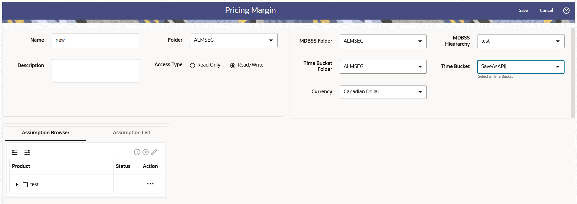

  1. Navigate to the Pricing Margin summary page.
  2. Click Add icon. The Add Pricing Margin page is displayed.
    Figure 3-106 Pricing Margin Page
    Pricing Margin Page
  3. Enter the following Details.
    Table 3-65 Create Pricing Margin Rule
    Fields Description
    Name Enter the name of the Pricing Margin Rule.
    Description Enter the description of the Pricing Margin Rule. This is an optional field.
    Folder Select the Folder where the Pricing Margin Rule needs to be saved.
    Access Type Select the Access Type as Read-Only or Read/Write.
    MDBSS Folder Select the MDBSS folder
    MDBSS Hierarchy Select the MDBSS hierarchy
    Time Bucket Folder Select the Folder from which you want to apply Time Bucket Rule.
    Time Bucket Rule Select the time horizon/aggregation for rule.
    Currency Select the currency for Pricing Margin
  4. Select an MDBSS hierarchy. You can define methodologies at any level of the MDBSS. The Hierarchical Relationship between the nodes allows the inheritance of methodologies from Parent nodes to Child nodes.
  5. Select MDBSS node(s) from Assumption Browser.
  6. Click Add from Assumption Browser Section.
  7. Click Save
