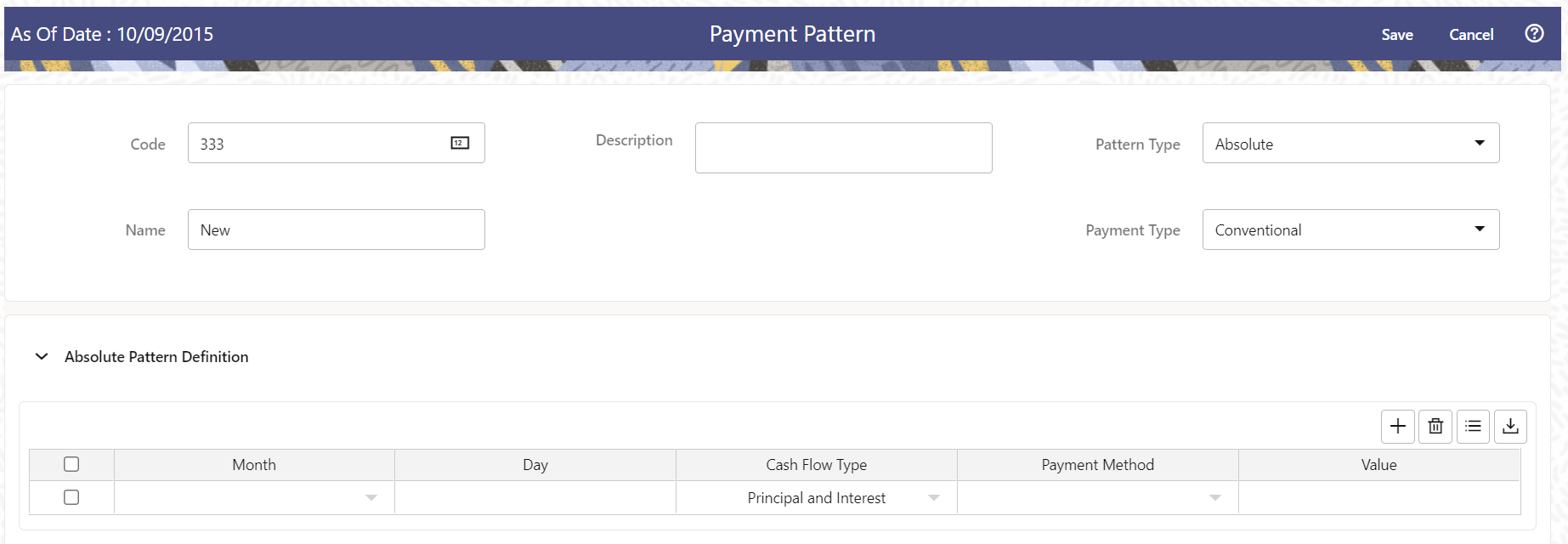

Figure 3-53 Absolute Payment Patterns
To define absolute payment pattern, do the following:
- In the Payment Patterns page, select Pattern Type as Absolute.
- Select the Payment Type from the drop-down list: Conventional, Level Principal, or Non-Amortizing. The Payment Type determines the type of information required to successfully define the Payment Phase.
- Define the Payment Phases. A Payment Phase is a set of payment
characteristics that defines the timeline of the instrument's amortization.
- Define the following parameters:
- Month: This drop-down list allows you to select the month of the payment phase being defined.
- Day: Used to specify the day of the month the payment is due.
- Select the Cash Flow Type. The available types depends on the Payment
Type. This do not apply to the Non-Amortizing Payment Type.
Table: Relationship between Cash Flow Type and Payment Types
Level Principal Non-Amortizing Conventional Principal and Interest Yes Yes Principal Only Yes Interest Only Yes Yes - Select the Payment Method. The available Payment Methods depend on the Payment Type. For more information, see: Relation between Payment Method and Payment Types. Payment Methods do not apply to the Non-Amortizing Payment Type.
- Enter the Value for the Payment Method you selected in the previous step for
applicable Payment Types.
If you selected the Interest Only Payment Method in the previous step, the Value field does not apply.
- Click the Add icon to add additional Payment Phases to the Pattern. Click Delete icon corresponding to the rows you want to delete.
- Click Add Multiple Row icon to enter the number of rows you want to add and click Go.
- The Download Excel icon helps you to export payment information, modify and
paste back in the UI.
A Payment Pattern must have at least one valid Payment Phase to be successfully defined. The system raises a warning if you try to save a Payment Pattern with an incomplete Payment Phase. - Click Apply and Save.
The Payment Pattern is saved and the Payment Pattern summary page is displayed.
