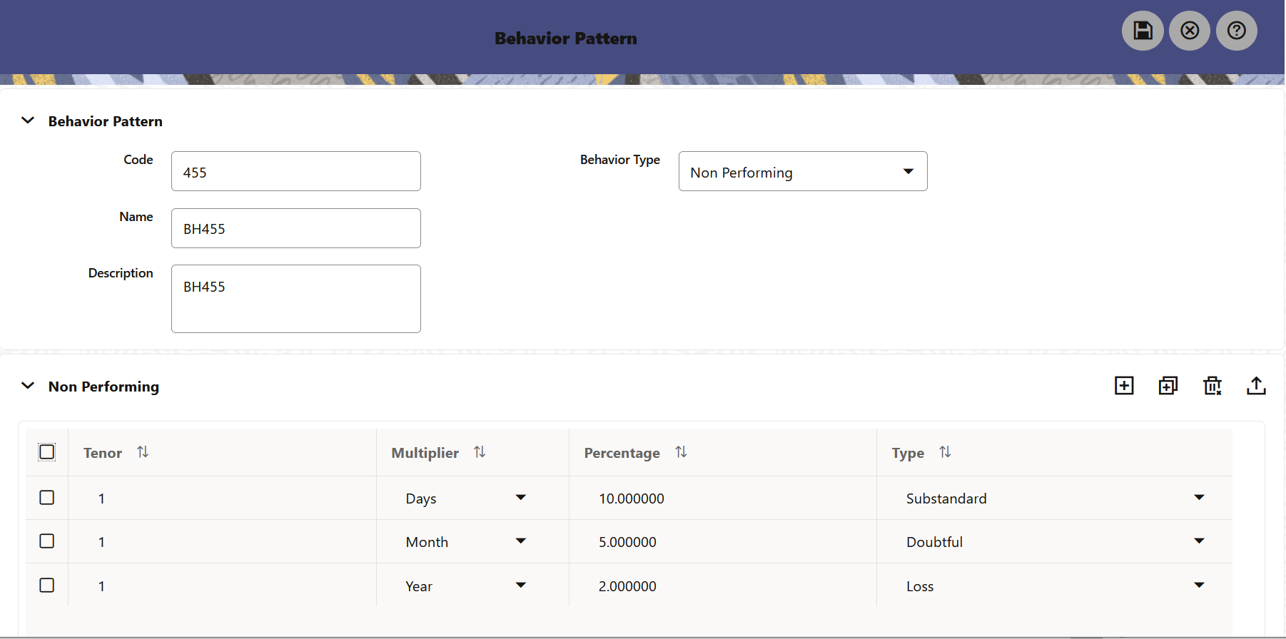

To define the Non-Performing Behavior Patterns, perform the following steps:
- In the Behavior Pattern Details Page, select Non-Performing as the Behavior Pattern Type.
- Click the Add icon to open the Non-Performing Behavior
Patterns Summary Page.
Figure 3-48 Behavior Pattern with Type as Non-Performing
- Enter or select the following details:
- Tenor: Specify the maturity tenor for the first maturity strip. For example, if “1 Day” is defined, then the applicable percentage of the balance will runoff (mature) on the As-of-Date + 1 Day.
- Multiplier: The unit of time applied to the Tenor. The choices
are:
- Days
- Months
- Years
- Percentage: The relative amount of the Principal Balance that will mature on the date specified by the Tenor + Multiplier. The percentage amounts can exceed 100% for Non-Performing Patterns.
- Type: This allows you to classify the Runoff based on the appropriate
type. The options are:
- Substandard
- Doubtful
- Loss
There is no difference in behavior from a Cash Flow perspective, but the Runoff Amount will be written to a Principal Runoff Financial Element corresponding to the selected Runoff Type.
- Click the Add icon to add additional payment strips to the Pattern and define appropriate assumptions for each strip.
- To delete a row, select the check box corresponding to the row(s) you want to remove and click the Delete icon.
- Click Save.
The Behavior Pattern is saved and the Behavior Pattern Summary Page is displayed.
