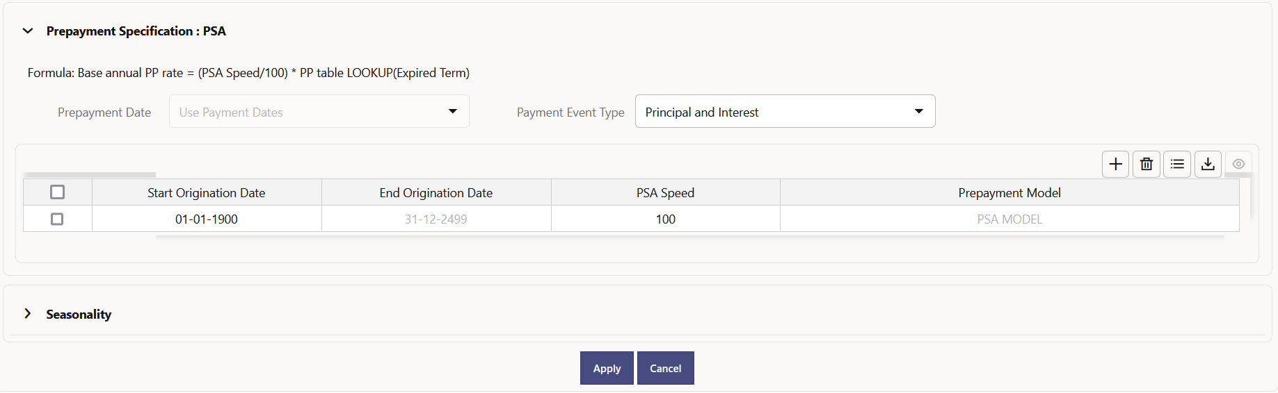

Figure 3-60 PSA Prepayment Method

  1. Select the Payment Event Type option.
  2. Select the Start Origination Date using the date picker. Alternatively, you can enter the Start Origination Date in the space provided.
    The first cell in the Start Origination Date Column and all the cells in the End Origination Date Column are Read-Only. This ensures that all possible Origination Dates have supporting reference values when Prepayment Assumption Lookups occur. Each row in the End Origination Date ColĀ­umn is filled in by the system when you click Add Row or save the Rule.
    The first Start Origination Date (in row 1) has a default value of January 1, 1900. When you enter a Start Origination Date in the next row, the system inserts a date that is a day before the previous End Origination Date Field.
  3. Enter the PSA Speed that you want to apply to the instruments having Origination Dates in a parĀ­ticular Start Origination-End Origination Date range. The PSA Method is based on a standard PSA curve. You can view the seeded model by selecting the View Prepayment Model icon.
    The default value is 100 PSA and inputs can range from 0 to 1667.
