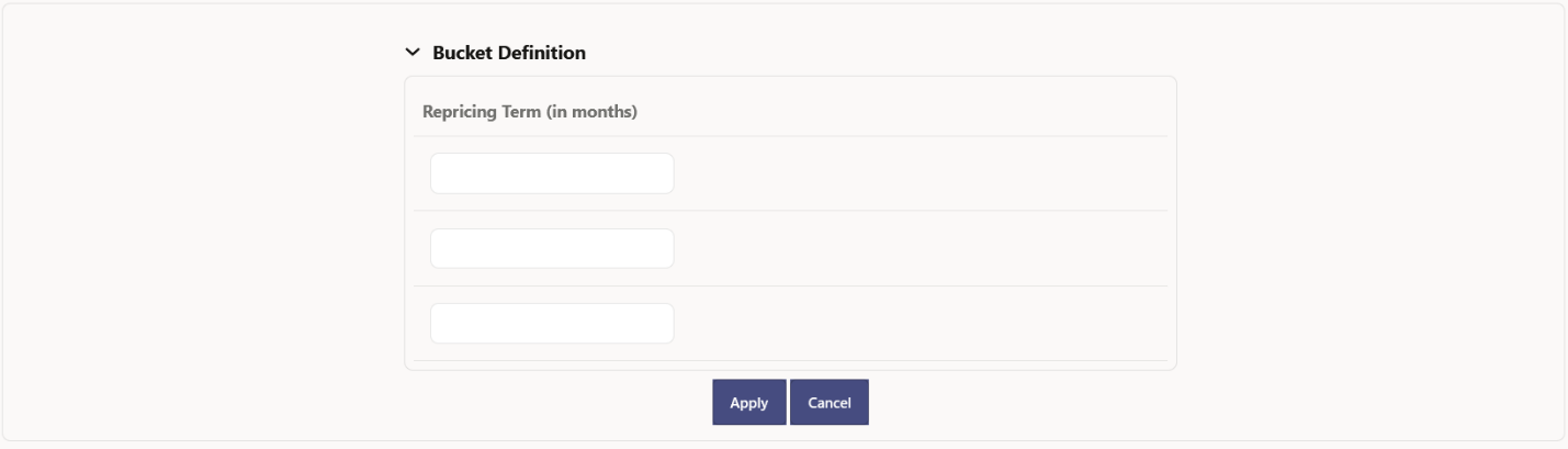

3.16.3.1.2 Modifying the Table Structure Using Bucket Definition section
The Bucket Definition section is used to perform following tasks:
  • To add more buckets to a particular Dimension, update the number of buckets for the Dimension and click Apply.
  • To delete buckets from a particular Dimension, reduce the number of buckets to the desired value and click Apply.
To change the Lookup Method of a particular Dimension, select the required method from the corresponding list of methods from the Dimensions Tab.
Figure 3-65 Bucket Definition Section
  1. Assign values for each of the buckets.
  2. Click Apply. The Prepayment Model, Prepayment Dimensions, and Buckets are saved.
