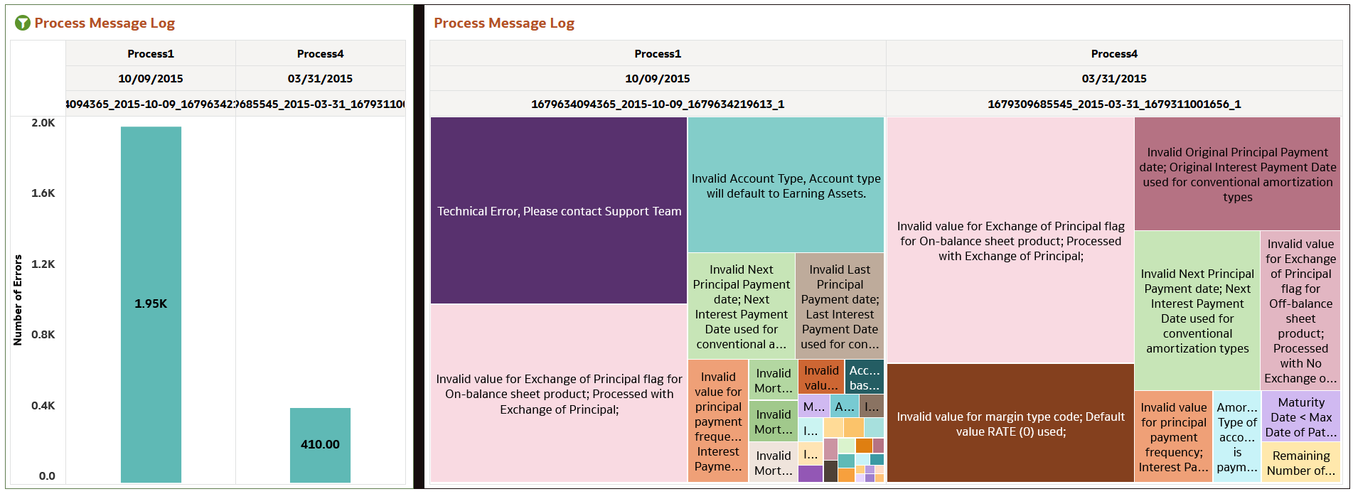

5.1.7.1.2 Process Error Summary
This report displays the summarized results of the Process Errors table.

Figure 5-130 Report
Report
