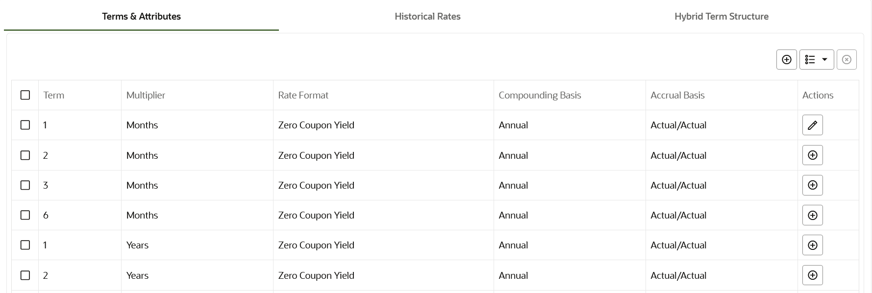

Figure 3-13 Terms and Attributes Tab
Click “+” at the term point where you want to modify attributes. Rate Format, Compounding Basis, and Accrual Basis fields are enabled for modification.
