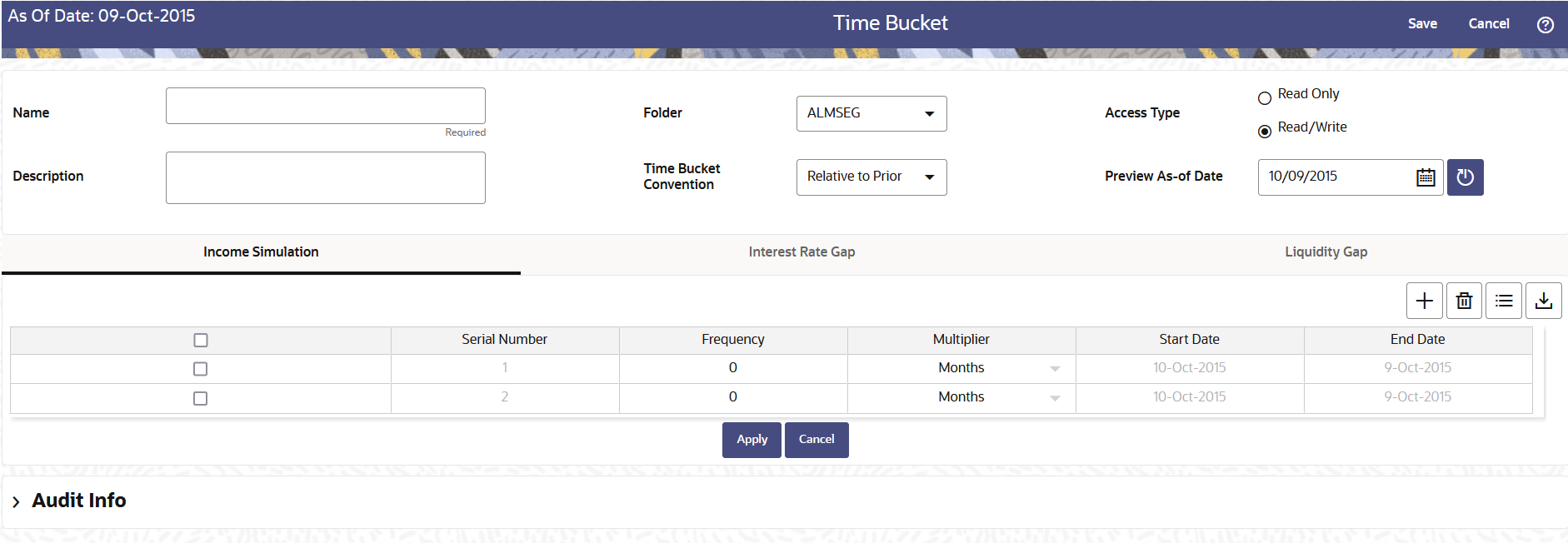

  1. Navigate to the Time Buckets Summary page.
  2. Click Add to create a new Time Bucket Rule.
    Figure 5-66 Creating Time Bucket Rule
  3. Enter the Name and Description of Time Bucket.
  4. Select the Folder and Access Type.
  5. Select Time Bucket Convention as Relative to Prior or Relative to As-of Date option.
    • Relative to Prior: This convention means that all time bucket points are relative to the period that preceded them, with the first time bucket relative to the currently active as-of date. This convention supports the stub-to feature for time buckets.
    • Relative to As-of-Date: This convention means that all time bucket points are relative to the currently active As-of Date. This means that each new time bucket point entered must be greater in time than the one preceding it by at least one day. The stub-to time bucket feature is not available with this convention.
  6. You must have an Active Time Bucket Rule at all times. If you wish to Activate a particular Time Bucket Rule, then select Relative to As-of- Date option.
  7. You can Preview As-of Date by using Preview As-of Date option.
