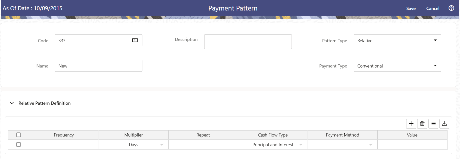

Figure 5-40 Relative Payment Patterns
To define a relative payment pattern, follow these steps:
  1. In the Payment Patterns page, select Pattern Type as Relative.
  2. Select the Payment Type from the drop-down list: Conventional, Level Principal, or Non-Amortizing. The Payment Type determines the type of information required to successfully define the Payment Phase.
    The payment type determines the available characteristics for defining the payment amount.
  3. Define the Payment Phase.
    The payment type determines the type of information required to successfully define the payment phase. For more details, see: Relation between Payment Phase Attributes and Payment Types.
    1. Enter the Frequency for each payment phase.
    2. Select the appropriate Multiplier for each payment phase from the following options:
      • Days
      • Months
      • Years
    3. Enter the number of times each Payment Phase should be repeated in the Repeat column.
    4. Select the Cash Flow Type. The available types depend on the Payment Type. This do not apply to the Non-Amortizing Payment Type.
      Table: Relationship between cash Flow Type and Payment Types
      Level Principal Non-Amortizing Conventional
      Principal and Interest Yes Yes
      Principal Only Yes
      Interest Only Yes Yes
    5. Select the Payment Method.
      The available payment methods depend on the payment type. For more details, see Relation between Payment Method and Payment Types. Payment Methods do not apply to the Non-Amortizing Payment Type.
    6. Type the Value for the Payment Method you selected in the previous step for applicable Payment Types.
  4. Click the Add icon to add additional Payment Phases to the Pattern. Click Delete icon corresponding to the rows you want to delete.
  5. Click Add Multiple Row icon to enter the number of rows you want to add and click Go.
  6. The Download Excel icon helps you to export payment information, modify and paste back in the UI.
    A Payment Pattern must have at least one valid Payment Phase to be successfully defined. The system raises a warning if you try to save a Payment Pattern with an incomplete Payment Phase.
  7. Click Apply and Save.
    The payment pattern is saved and the Payment Pattern home page is displayed.
