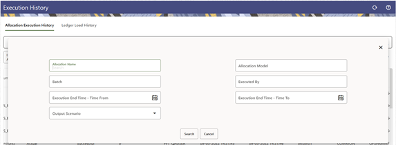

  1. Click the Search icon on the Search Pane to display the Criteria Window.
  2. Enter the Allocation Rule Name, Allocation Model Name, Batch, Executed By, Execution End Time, or the Output Scenario and click Search to display the Allocation Rules that match the criteria.
  3. Click Cancel to remove the filter criteria on the Search Window and refresh the Window.
  4. Click Search after entering the Search Criteria.
    Figure 5-48 Allocation Execution History – Criteria Window
    The Allocation Execution History Criteria window displays the fields for Allocation Rule Name, Allocation Model Name, Batch, Executed By, Execution End Time, or Ouput Scenario parameters. You can enter any one or more search parameters to see the rules that meet the Search Criteria.
    The screen displays the search results that meet the Search Criteria in a table containing all the Allocation Rules.
    You may search based on the following parameters:
    • Allocation Name: Performs a wild card search on Allocation Rule Name. You can execute the search when you select the Search button.
    • Allocation Model: Performs a wild card search on Allocation Model Name under which different Allocation Rules are grouped together. You can execute the search when you select the Search button.
    • Batch: Performs a wild card search on Batch Name. You can execute the search when you select the Search button.
    • Executed By: Performs a wild card search on the logged-in username that has executed the rule when rule execution happened through Allocation Summary. While it performs a wild card search on the username that has been passed as a parameter in the batch when rule execution happened through batch method.
    • Execution End Time: Restricts the number of rules displayed on the Allocation Execution History summary screen based on a user's specification of a single execution date and a no earlier than Execution End Time – Time From and a no later than Execution End Time – Time To. You can execute the search when you select the Search button.
    • Output Scenario: Performs a wild card search on the Output scenario for any Allocation Rule. You can execute the search when you select the Search button.
