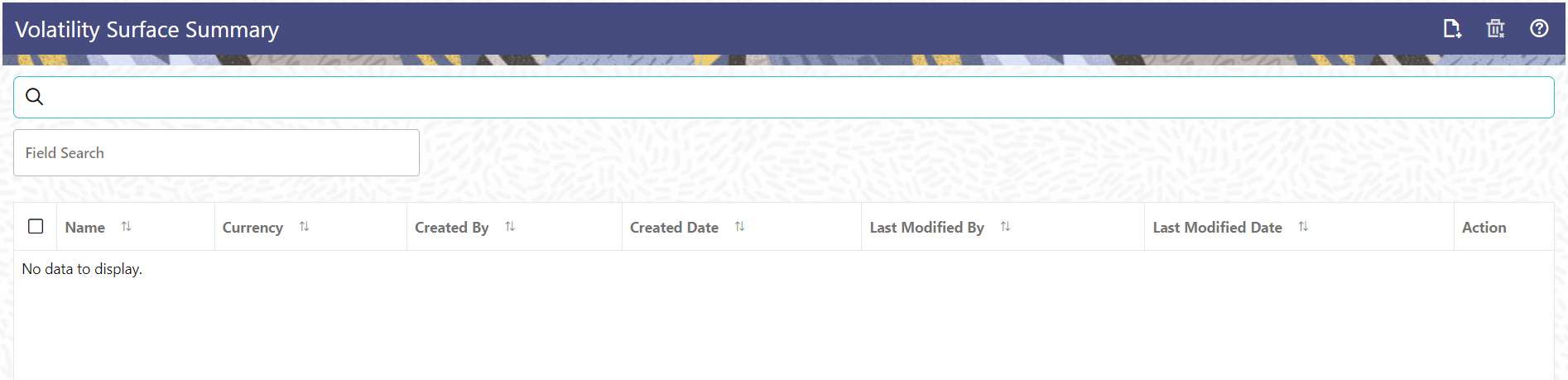

Volatility Surface Rule Summary
This page is the gateway to all Volatility Surface Rules and related functionality. You can navigate to other pages relating to Volatility Surface Rules from this point.
Figure 5-105 Volatility Surface Rule Summary
Search Volatility Surface Rule
Prerequisites: Predefined Volatility Surface Rule
To search for a Volatility Surface Rule:
Click Search after entering the search criteria. The search results are displayed in a table containing all the Volatility Surface Rules that meet the search criteria.
Or
An alternative method to search a Volatility Surface Rule is through the Field Search option. This is an inline wildcard UI search that allows you to enter a search value (such as code, name, etc.) partially or fully. Rows that contain the string you are searching for are fetched and displayed in the Volatility Surface Rule Summary. You can enter the Code, Name, Currencyand Description, of the Volatility Surface Rule and click Search .
The Volatility Surface Rule Summary displays the following information:
Add: Click the Add icon on the page header to build a new Volatility Surface Rule.
  • Name: The Volatility Surface Rule's short name.
  • Currency: The Volatility Surface Rule's currency.
  • Created By:The Name of the user who created the Volatility Surface.
  • Created Date: The Date and Time at which the Volatility Surface was created.
  • Last Modified By: The user who last modified the Volatility Surface Rule.
  • Last Modified Date: The Date and Time when the Volatility Surface Rule was last modified.
  • Access Type: The access type of the rule. It can be Read-Only or Read/Write.
  • Action: Click this icon to view a list of actions that you can perform on the Volatility Surface Rule.
    • Multiple Delete: Enables you to select and delete one or multiple rules in the table simultaneously.
    • View/Edit: Based on the user privilege assigned, you can either only view or edit existing Volatility Surface Rules. To edit a rule, you must have Read/Write privilege.
    • Save As: You can reuse a Volatility Surface Rule by saving it under a new name thus saving time and effort in entering data multiple times; it also leads to reduced data entry errors.
    • Delete: You can delete Volatility Surface Rules that you no longer require. Note that only Volatility Surface Rule owners and those with Read/Write privileges can delete Volatility Surface Rules. A Volatility Surface Rule that has a dependency cannot be deleted.
    • Dependency Check: You can perform a dependency check to know where a particular Volatility Surface Rule has been used. Before deleting a rule, it is always a good practice to do a dependency check to ensure you are not deleting Volatility Surface Rules that have dependencies. . A report of all rules that utilize the selected Volatility Surface Rule is generated.
