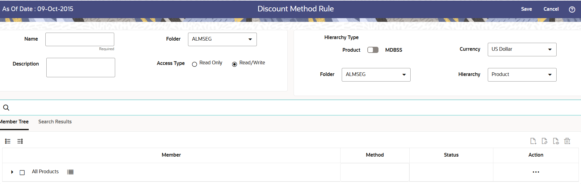

  5. Select the Hierarchy Type as Product or MDBSS
    MDBSS is enabled only in ALM Cloud Service.
    If any member is a currency in the MDBSS hierarchy (for example, INR) and selected currency is different (for example USD), then the member and its children nodes cannot be defined.

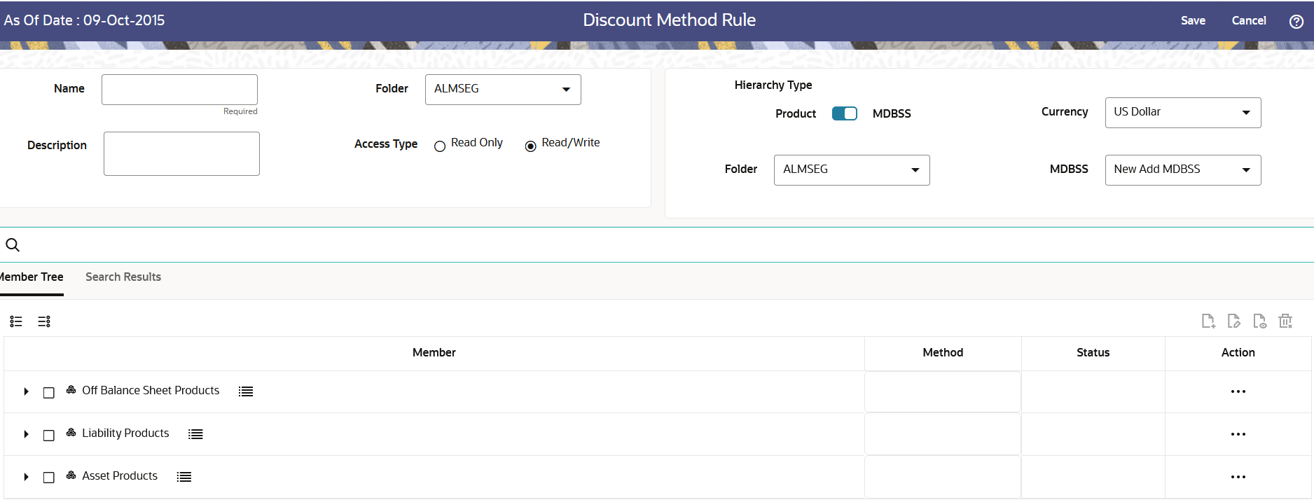

    • If you select Hierarchy Type as MDBSS, then following options are available:
      Figure 5-138 Hierarchy Type as MDBSS
      1. Select a Currency.
      2. Select a MDBSS Folder and MDBSS.
      3. SelectMDBSS Node(s) from Member Tree of Assumption Browser. The Assumption Browser has following two tabs: Member Tree and Search Results

    • If you select Hierarchy Type as Product, then following options are available:
      Figure 5-142 Hierarchy Type as Product
      2. Select a Product Folder and Product Hierarchy.
      3. Select Product from Member Tree of Assumption Browser. The Assumption Browser has following two tabs: Member Tree and Search Results

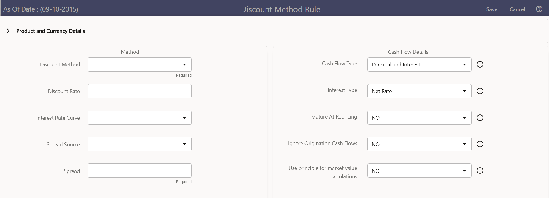

  8. Navigate to Discount Method section.
    Figure 5-146 Discount Method Section
  9. Enter the following details:
    Table 5-39 Discount Method Section
    Fields Description
    Discount Method Select the Discount Method from Discount Method List.
    Discount Rate Enter Discount Rate if Spot Input Method is selected.
    Interest Rate Curve
    From Interest Rate Code List, select an appropriate Interest Rate Code.
    The list of Interest Rate Codes depends on the selected currency. If the selected currency is the default currency, all Interest Rate Codes appear. For other currency selections, the list of interest rate codes includes only interest rate codes whose reference currency is the same as the selected currency.
    Spread Source
    You can optionally choose to add a spread of margin over the Interest Rate derived from IRC. Spread can be defined in the Discount Method Rule or it can be given along with Instrument record.
    You can select source of the spread as Discount Rule or Account Data is method is Spot IRC, Forecast (Original Term) and Forecast (Remaining Term).
    Spread
    When Discount Rule is selected as Spread Source then you can specify the amount of spread/margin here.
    Spread field is enabled when spread Source is given as Account Data.
    Type the percentage difference (+ or -) between the selected rate index and the value you want to use for the discount rate(s) within market value calculations.
    Input a Rate Spread, type 1.0000.
    A spread of 1% returns a discount rate of 1.00% above the reference interest rate. Type a negative number for a spread below the reference interest rate.
    You can use negative product IDs when defining the Discount Method Rule.
  10. Navigate to Cash Flow Details section. The Cash Flow Definition Details section is used in unique instances to specify the portion of the Cash Flow that is used to calculate a Market Value.
  11. Enter the following details:
    Table 5-40 Cash Flow Details Section
    Fields Description
    Cash Flow Type
    1. Interest Only : ignores all principal runoff for market value purposes. Use this option for Off-balance sheet items where principal is equal to Notional Principal and is therefore not a true Cash Flow.
    2. Principal & Interest : calculates principal and interest both for Market Value purposes.
    3. Principal Only : ignores all interest rate Runoff for market value purposes.
    Interest Type
    The Cash Flow Interest Type determines which interest component is included in the cash flow definition. The Cash Flow Interest Type can be one of three values:
    • Net Rate
    • Gross Rate
    For typical processing, you will use the Net Rate for the interest component of the cash flow. Special processing objectives, such as valuation of the funding center, may require you to use the other cash flow interest types.
    Mature at Repricing Calculates a market value and YTM for a given transaction up to the repricing date. For market value and YTM purposes the transaction is assumed to mature on the repricing date. Duration is always calculated to the next reprice date, not to maturity, regardless of the mature at repricing selection.
    Ignore Origination Cash Flows for Forward-Starting Instruments This feature allows the cash flow engine to ignore the origination Principal Cash Flows of any forward-starting instrument. The corresponding market value, duration, convexity and yield calculations will not reflect the Origination Amount. Origination principal Cash Flow will still be reported.
    Use Principal in Market Value Calculations (Off-Balance Sheet Only) This feature allows the Cash Flow Engine to consider principal in the calculation of market value, duration, convexity and yield calculations, even if principal is not actually exchanged.
