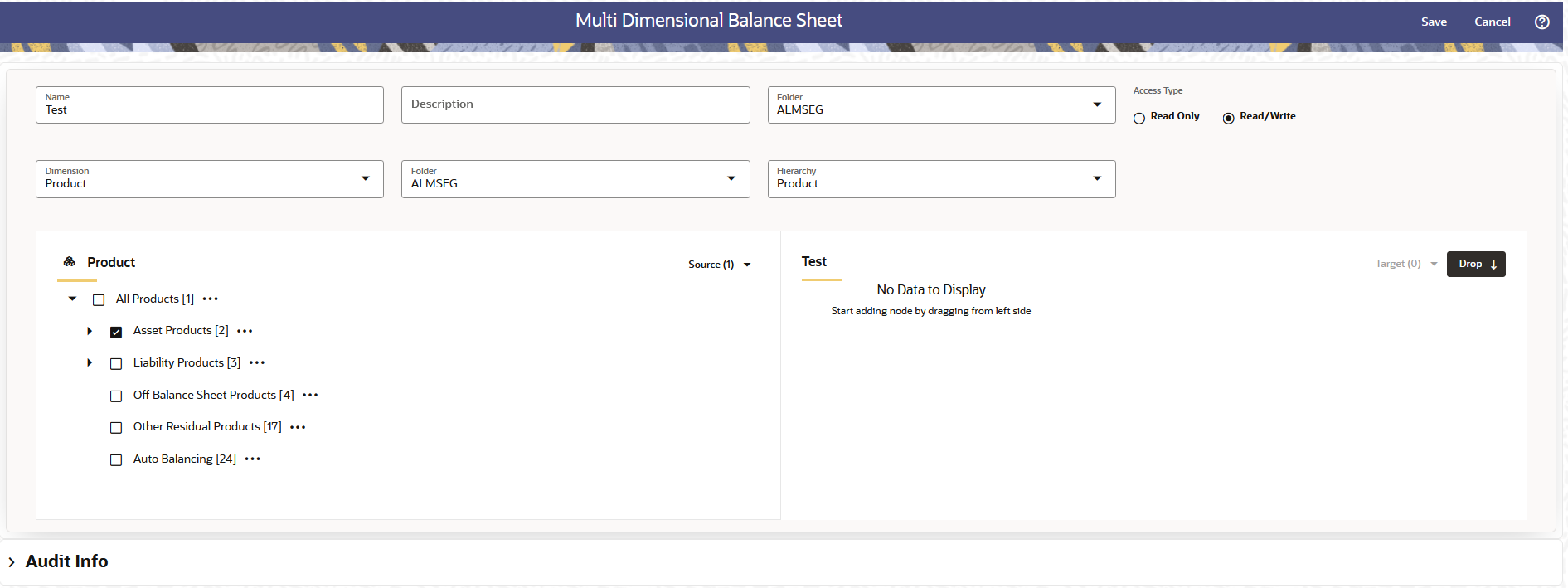

- Enter the following details:
Table 5-11 Create MDBSS Rule
Fields Description Name Enter the name of the Multi Dimensional Balance Sheet Rule. Description Enter the description of the Multi Dimensional Balance Sheet Rule. This is an optional field. Folder Select the Folder where the Multi Dimensional Balance Sheet Rule needs to be saved. Access Type Select the Access Type as Read-Only or Read/Write. Dimension Select the Dimension of the Multi Dimensional Balance Sheet Rule. Folder Select the Hierarchy Folder of the Multi Dimensional Balance Sheet Rule. Hierarchy Select the Hierarchy of the Multi Dimensional Balance Sheet Rule. Note:
Based on the selected Dimension from Dimension drop-down list, the Dimension Source selection options will vary. For example,- If Dimension is selected as “Product”, then Product Folder and Product
Hierarchy fields will be available.

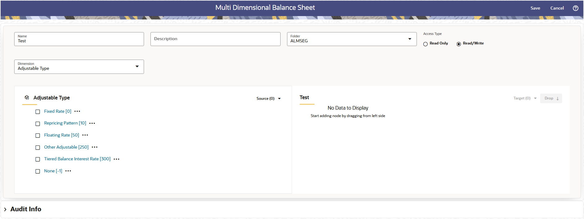

Figure 5-13 MDBSS Rule
- If Dimension is selected as “Adjustable Type”, then only list of Adjustable
Types will be available.
Figure 5-14 MDBSS Rule
- Select the Source of Dimension from Dimension drop-down list. You can click Source option to Select All or Unselect All.
- Select the Target Node of Dimension. Here, You can select more than one Nodes at a time.
- Click Drop. You can use Revert option to reverse the selection.
- Click Target option to Select

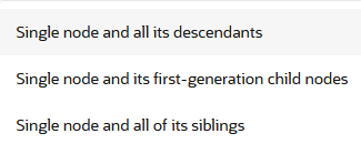

- When you select a Node from Source section, then following
options are available:
Figure 5-15 MDBSS Rule
- Single node and all its descendants: Allows to select node itself along with its descendants.
- Single node and its first-generation child nodes: Allows to select node itself along with its child nodes
- Single node and all of its siblings: Allows to select node itself along with its siblings nodes

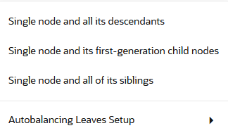

- When node is moved to Target section, then following options are
available:
Figure 5-16 MDBSS Rule
- Autobalancing Leaves Setup: Allows you to setup the Autobalancing for selected node as Asset, Liability, or Retained Earning.

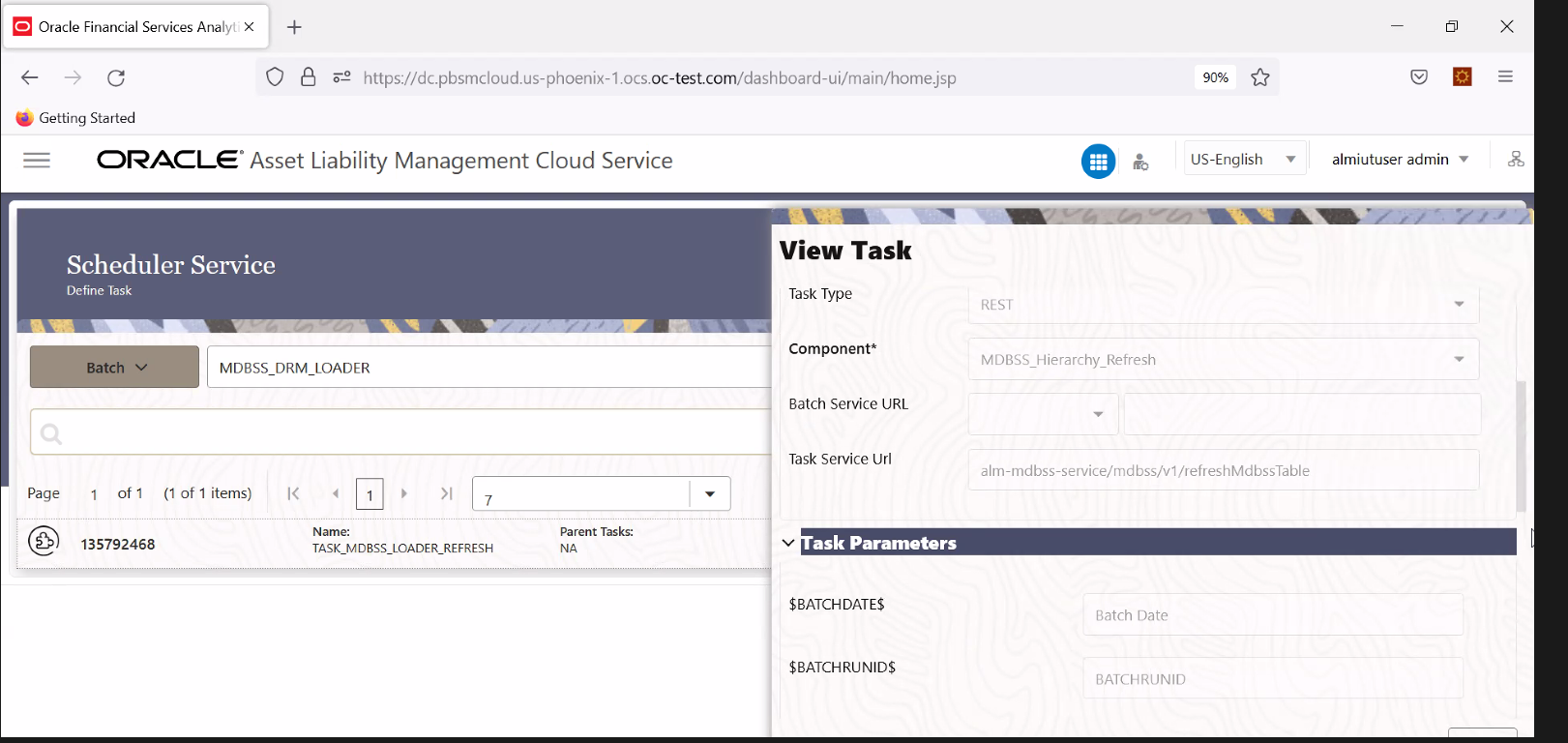

If you are using a DRM loader in ALMCS for MDBSS, follow these mandatory steps:
- Complete all the steps mentioned in DRM Loader. For more information, see the DRM loader section.
- Navigate to Operations and Process from LHS, then select Scheduler.
- Create a Batch, and then click Define Task.
- Define DRM loader task(s).
Figure 5-17 MDBSS_DRM_Loader seeded batch
- Create two tasks with Components as MDBSS_Hierarchy_Refresh and Member_Browser_Refresh to refresh the member Hierarchy data created by AMHM.
- Click Ok.
- Execute the Batch. For more information, see the Scheduler Service.
