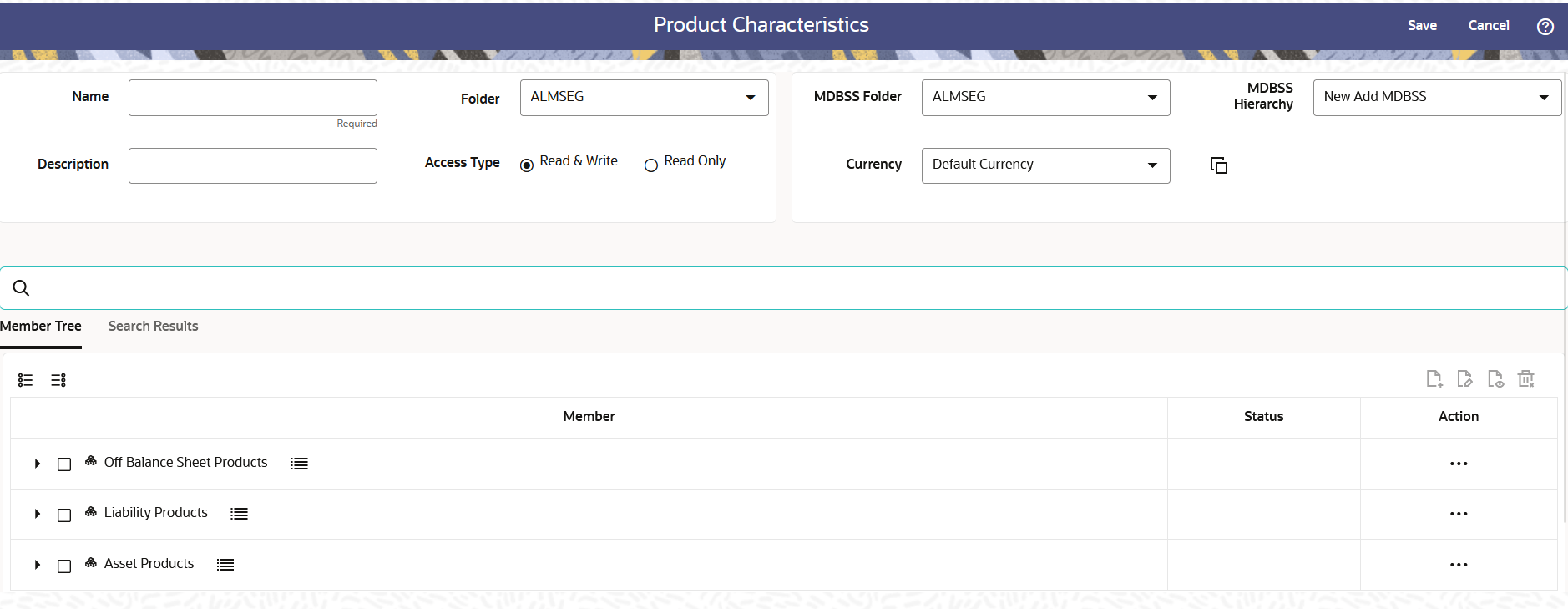

5.3.1.1 Create Product Characteristic Rules
You create a Product Characteristics Rule to assign attributes to the products.
Figure 5-54 Product Characteristics Page
To create a new Product Characteristics Rule, follow these steps:
- Click Add icon from the top of the Product Characteristics Summary Page.
- Enter the following Details.
Table 5-20 Create Product Characteristics Rule
Fields Description Name Enter the name of the Product Characteristics Rule. Description Enter the description of the Product Characteristics Rule. This is an optional field. Folder Select the Folder where the Product Characteristics Rule needs to be saved. Access Type Select the Access Type as Read-Only or Read/Write. MDBSS Folder Select the MDBSS folder Currency Select the currency for Product Characteristics Rule MDBSS Hierarchy Select the MDBSS hierarchy Note:
If any member is a currency in the MDBSS hierarchy (for example, INR) and selected currency is different (for example, USD), then the member and its children nodes can not be defined.
- Select MDBSS node(s) from Member Tree tab of Assumption Browser.
Assumption Browser has two tabs: Member Tree and Search Results.
- Member Tree: Member Tree tab shows the hierarchical
structure and allows you to define rules by selecting the node members from
the browser. Select Node and Click Menu icon next to it to view the
available options.
Figure 5-55 Member Tree Selection
Status of node is also displayed in Member Tree section, for example Selected, and so on. To select member hierarchy, following options are available:
