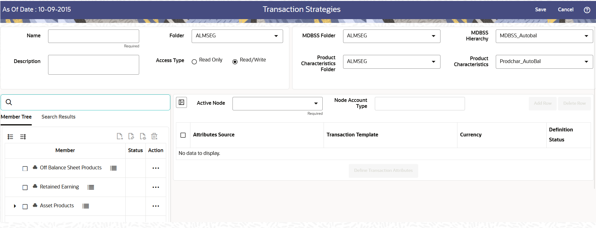

5.3.13.1 Create Transaction Strategy Rules
You create a Transaction Strategy Rule to define Transaction Strategy assumptions.
To create a new Transaction Strategy Rule, follow these steps:
  • Click Add icon from the top of the Transaction Strategy Rule Summary page. The Transaction Strategies window is displayed:
    Figure 5-167 Transaction Strategy Rule
  • Enter the following Details.
    • Name: Enter the name of the Transaction Strategy Rule.
    • Description (optional): Enter the description of the Transaction Strategy Rule.
    • Folder: Select the Folder where the Transaction Strategy Rule needs to be saved.
    • Access Type: Select the Access Type as Read-Only or Read/Write.
  • Select a MDBSS Folder and MDBSS.
  • Select Product Characteristics Folder and Product Characteristics.
  • Select MDBSS Node(s) from Member Tree of Assumption Browser. The Assumption Browser has following two tabs: Member Tree and Search Results.
    MDBSS is enabled only in ALM Cloud Service.
