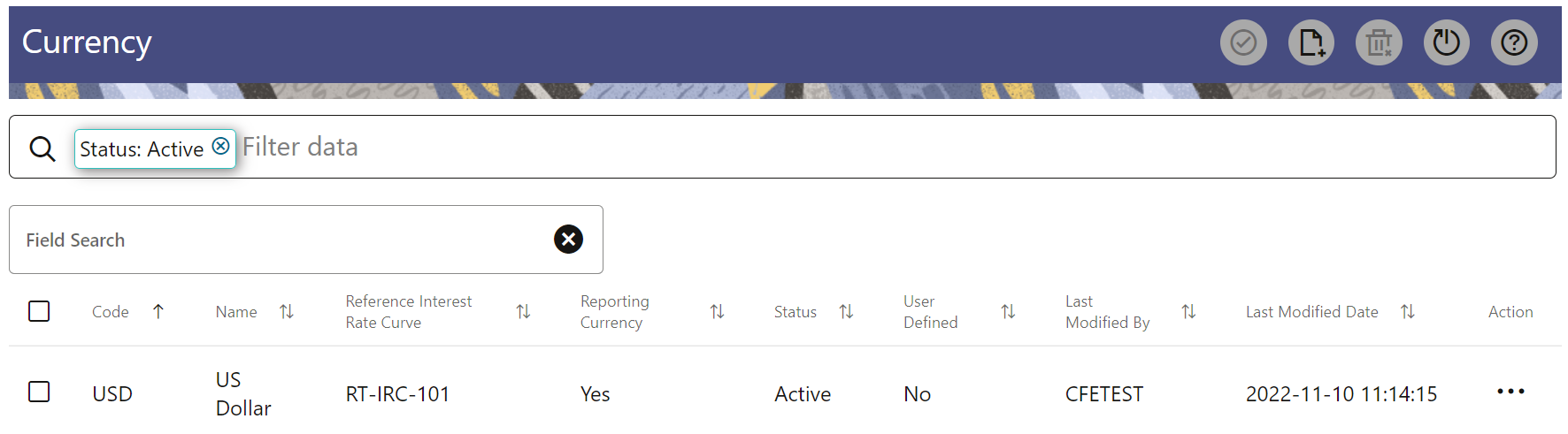

Currency Summary
This page is the gateway to all Currencies and related functionality. You can navigate to other pages relating to Currencies from this point.

Search Currency
Prerequisites: Predefined Currency
To search for a Currency:
Click Search after entering the search criteria. The search results are displayed in a table containing all the Currencies that meet the search criteria.
Or
An alternative method to search a Currency Rule is through the Field Search option. This is an inline wildcard UI search that allows you to enter a search value (such as code, name, etc.) partially or fully. Rows that contain the string you are searching for are fetched and displayed in the Currency Rule Summary. Enter the Code, Name, Status, Reporting Currency, or User Defined of the Currency and click Search .
The Currency Rule Summary displays the following information:
