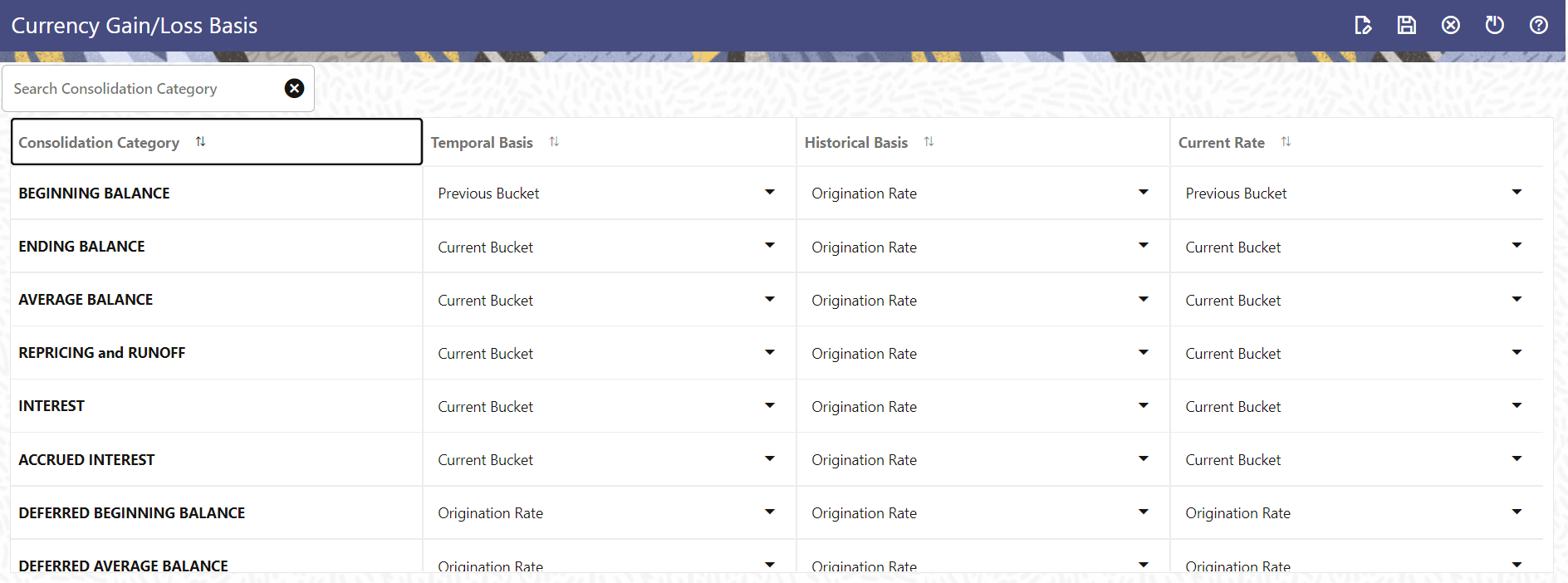

Currency Gain or Loss Basis determines how exchange rate fluctuations are reflected in financial element results for each product and currency combination. This provides the flexibility to use any specific exchange rate for Consolidation purposes the choices are:
  • Temporal
  • Historical Basis
  • Current Rate
Consolidation categories allows Financial Elements that can be used as aggregating output drivers within the Currency Gain/Loss methods. The below table shows the relationship between Consolidation output to FE number and Output column base values by default, upon selection there is a drop down facility which enables user to choose drivers based users preference.
Figure 5-67 Currency Gain/Loss Basis
Table 5-26 Currency Gain/Loss Basis
Icon Description
Edit Edit TEMPORAL BASIS using corresponding drop-down list. This field has following values:
  • Origination Rate
  • As of Date
  • Current Bucket
  • Previous Bucket
Edit HISTORICAL BASIS using corresponding drop-down list. This field has following values:
  • Origination Rate
  • As of Date
  • Current Bucket
  • Previous Bucket
Edit CURRENT RATE using corresponding drop-down list. This field has following values:
  • Origination Rate
  • As of Date
  • Current Bucket
  • Previous Bucket
Save After modifying values, click Save icon.
Cancel After modifying values, user can click Cancel icon to undo the changes before saving.
Reset to Default The Reset to Default icon enables you to bring the configuration back to factory setting at anytime.
Help Click this to open help file.
