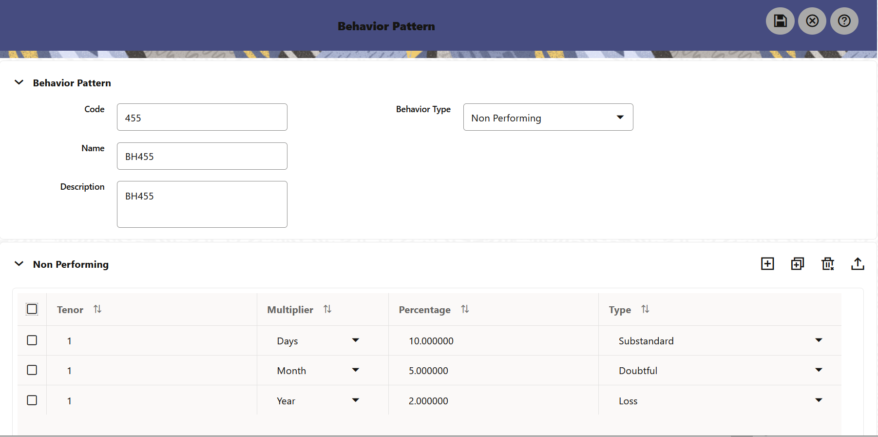

- In the Behavior Pattern Details Page, select Non-Performing as the Behavior Pattern Type.
- Click the Add icon to open the Non-Performing Behavior
Patterns Summary Page.
Figure 5-36 Behavior Pattern with Type as Non-Performing
- Enter or select the following details:

- Click the Add icon to add additional payment strips to the Pattern and define appropriate assumptions for each strip.
- To delete a row, select the check box corresponding to the row(s) you want to remove and click the Delete icon.
- Click Save.
The Behavior Pattern is saved and the Behavior Pattern Summary Page is displayed.
