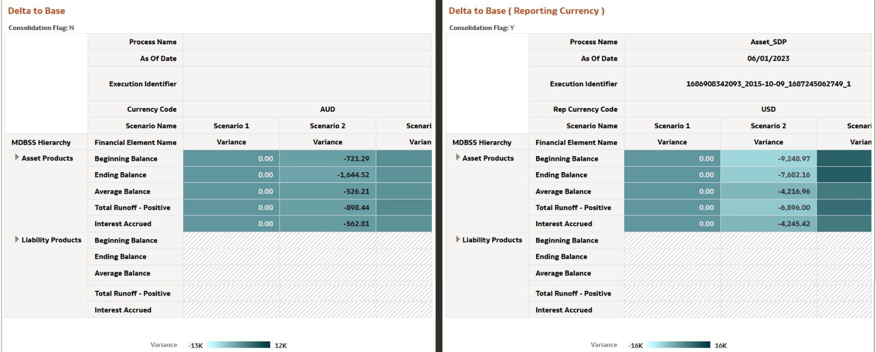

7.1.7.3.11 Financial Results MDBSS (Delta Report)
Delta report displays the comparison between Scenarios based on defined filters. Scenario 1 is used as the base Scenario for comparison. The Delta report shows for Base Currency and Reporting Currency. This report shows data for Financial Elements: Beginning Balance, Ending Balance, Average Balance, Total Runoff- Positive, and Interest Accrued. This shows the MDBSS hierarchies by as of date, Consolidation Flag, Currency code, Bucket Name. These Reports can be drilled down or rolled up for the user convenience.

Figure 7-171 Financial Results MDBSS (Delta) Report
