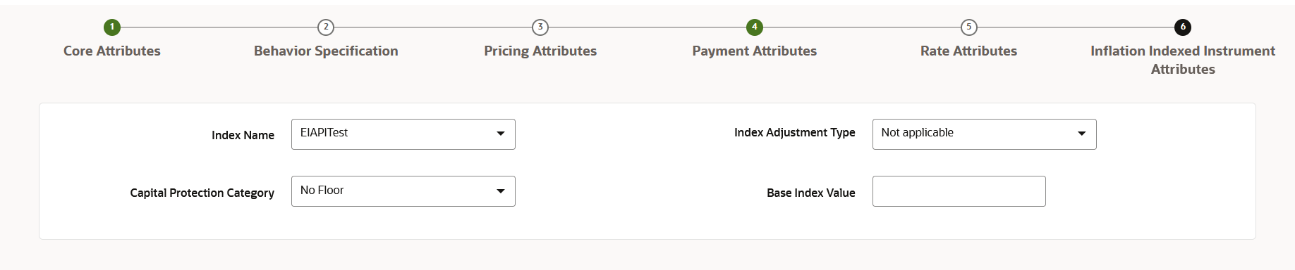

5.3.13.2.1.6 Inflation Adjustment Attributes
Select the Inflation Indexed Instrument check box on the Core Attributes section to enable the Inflation Adjustment Attributes section.
Figure 5-177 Inflation Adjustment Attributes section
Table 5-49 Fields to add the Index Adjustment attributes and their Descriptions
| Field | Behavior |
| Index Name | Lists all Economic Indicators defined through the user interface. |
| Index Adjustment Type |
Determines the type of Index Adjustment. Available options are: Principal and Interest Principal Only Interest Only |
| Capital Protection Category |
Determines capital protection to be provided to Inflation Indexed Instruments. Available options are: No Floor: Does not provide any downside protection. Floor of 1: Protects the downside movement. Max during Life: Gives maximum advantage using maximum Index factor for calculation. |
| Base Index Value | Base Index Value can either be entered into field Base Index Value or left blank. If it is blank, the engine will obtain Base Index Value from the forecasted Economic Indicator for defined Transaction Strategy Origination Date. This date is looked up into the forecasted Time Bucket, and the respective index data of that Time Bucket is obtained. If the Base Index Value is entered, the engine will consider it for calculation. |
