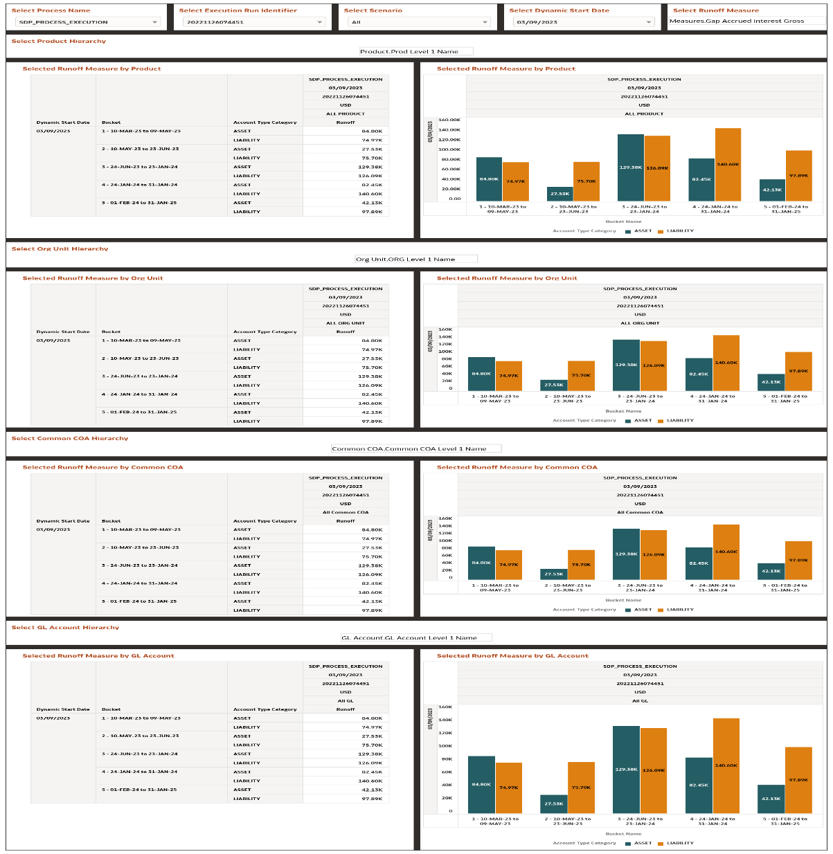

7.1.7.1.6 Interest Rate Risk Runoff
The “Interest Rate Risk Runoff” Report provides insight into the amount of assets and liability getting repriced in each time bucket. While fixed rate instruments runoff as per contractual maturity, adjustable rate instruments are assumed to runoff on the Next Reprice Date.
You can use a series of Report Prompts, as previously described, to filter the data according to key attributes pertaining to the underlying Interest Rate Risk Output results.
The report displays the underlying data according to the following Chart’ logic:

- Selected Runoff Measure by Product
The table and chart reports the generated Interest Rate Risk output Runoff Measure by Product for each Interest Rate Risk Output execution with respect to As of Date and Bucket Name.
The columns displayed in the chart are the following:
- Dynamic Start Date
- Bucket Name
- Account Type Category
- Process Name
- As of Date (Day)
- Execution Run Identifier
- Currency Code
- Product Hierarchy
- Runoff Measure
- Selected Runoff Measure by Org Unit
The table and chart reports the generated Interest Rate Risk output Runoff Measure by Org Unit for each Interest Rate Risk Output execution with respect to As of Date and Bucket Name.
- Bucket Name
- Process Name
- As of Date (Day)
- Currency Code
- Org Unit Hierarchy
- Runoff Measure
- Selected Runoff Measure by GL Account
The table and chart reports the generated Interest Rate Risk output Runoff Measure by GL Account for each Interest Rate Risk Output execution with respect to As of Date and Bucket Name.
- Bucket Name
- Process Name
- As of Date (Day)
- Currency Code
- GL Account Hierarchy
- Runoff Measure
- Selected Runoff Measure by Common COA
The chart reports the generated Interest Rate Risk Output Runoff Measure by Product for each Interest Rate Risk Output execution with respect to As of Date and Bucket Name.
- Bucket Name
- Process Name
- As of Date (Day)
- Currency Code
- Common COA Hierarchy
- Runoff Measure
Figure 7-130 Interest Rate Risk Runoff Report
