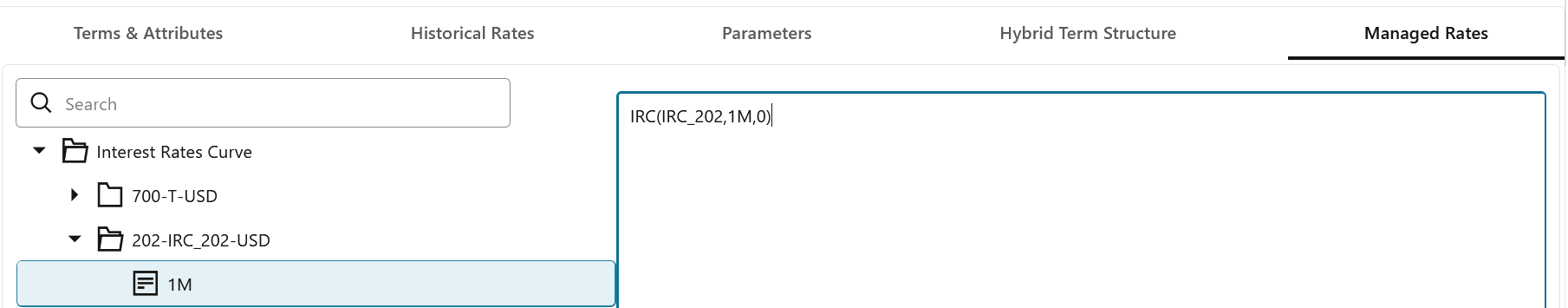

For example, suppose you want a formula that refers to an interest rate curve's 1 month tenor on a current basis, then its syntax would look something like this:
Figure 5-7 Example of Managed Rate
Here,
[IRC_202] is the IRC code (Object ID)
[1M] is the Term.
[0] is time. This calculates Past, present or future dates/rates with ease for any term/tenor and forecast method definition. The default value is 0. [0] means the now. [-1] refers to back one period. [$] refers to constrained time period.

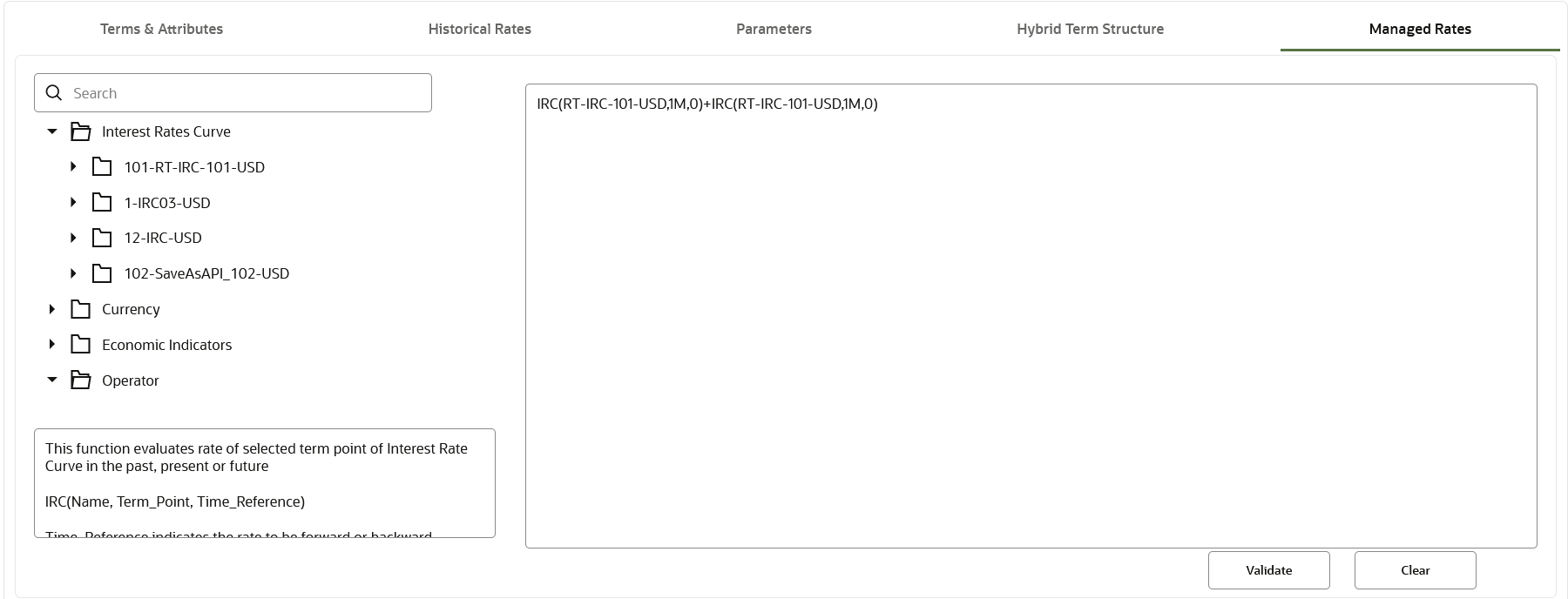

To define Managed Rate, follow these steps:
- Select Structure Type as Managed Rates.
- Navigate to Managed Rates tab.
This tab will be active only when Structure Type is selected as Managed Rates. - Select the Function type as Interest Rate Curve, Currency, or Economic Indicator to define a formula.
- Double-click the Function code to move it to Formula section.
- Update the formula. Use arithmetical operator from Operator to define
formula if required.
Figure 5-8 Formula section
