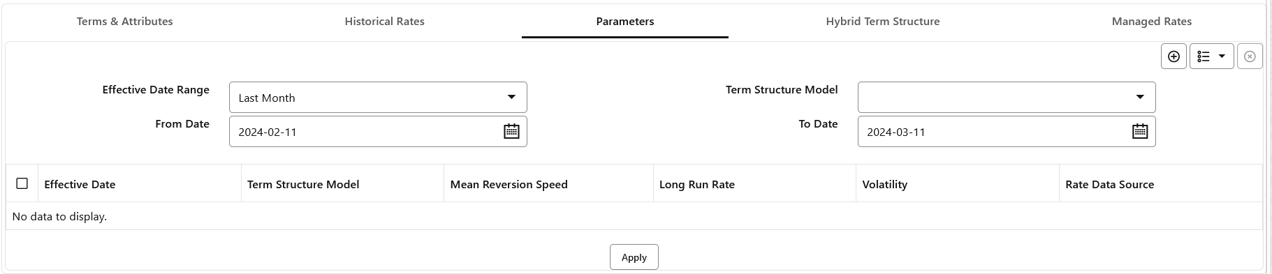

To define the Parameter Estimation, follow these steps:
- Navigate to Parameters tab of Interest Rate Curve.
Figure 5-6 Parameters Tab on Interest Rate Curve window
- Enter the Effective Date Range filter.
- After clicking Add, default parameters for the Extended Vasicek Model are displayed for one Effective Date (the System Date on which the Interest Rate Code was created). You can edit these parameters or add new parameters using Add.
- Enter the Effective Date. Note that the Effective Date cannot be greater than the Current System Date.
- Select the Model from the Term Structure Model drop-down list. Effective Date and Term Structure Model combination must be unique within this IRC.

Table 5-7 List of supported parameters for Models Term structure models in Interest Rate
Model Parameter 1 Parameter 2 Parameter 3 Extended Vasicek Volatility Mean Reversion Speed Ho and Lee Volatility Merton Volatility Vasicek Volatility Mean Reversion Speed Long Run Rate - Enter values for Long Run Rate and
Volatility in percentages.
For example, a Long Run Rate of 5% is displayed as 5.000. To maintain the integrity of data, Rate Management restricts the accepted input values. The valid range and the default setting for each parameter.
Table 5-8 Valid Range and Default Values of Interest Rate Parameters
Parameter Valid Range Default Value Volatility 0% to 500% 0.01 Mean reversion speed 0.00 to 500 0.0 Long run rate 0.00% to 500% 0.0 - Click Apply.
