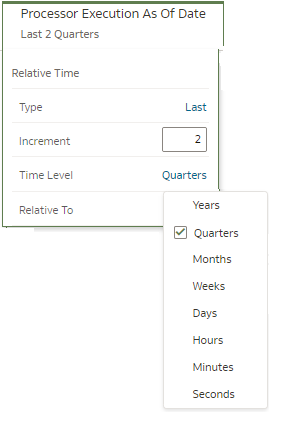

- Processor Execution As of Date: The Execution Period of the Cash Flow
Edit process. You can use this filter to isolate a selected timeframe for the
analysis. The following screenshot displays the possible options that this filter
provides against the Time Dimension.
Figure 7-109 As of Processor Execution Date Selection
