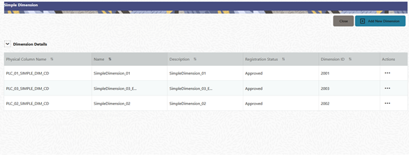

The Cloud Service Data Model comes with a set of placeholder Simple Dimensions for configuration and use. The member details of simple dimensions are stored in two tables:
- A code table (For example, FSI_SIMPLE_DIM_01_CD)
- A Multi-Language Support table (for example, FSI_SIMPLE_DIM_01_MLS)
To register a Simple Dimension:
