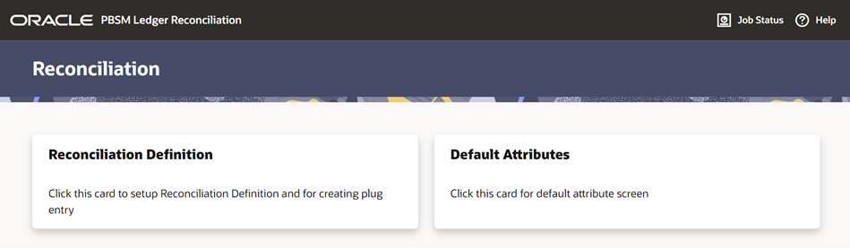

The Balance Reconciliation landing screen displays the following two cards:
  • Reconciliation Definition
  • Default Attributes

Figure 4-46 Reconciliation Landing Screen
The Reconciliation landing screen displays the Reconciliation Definition and Default Attributes cards.
