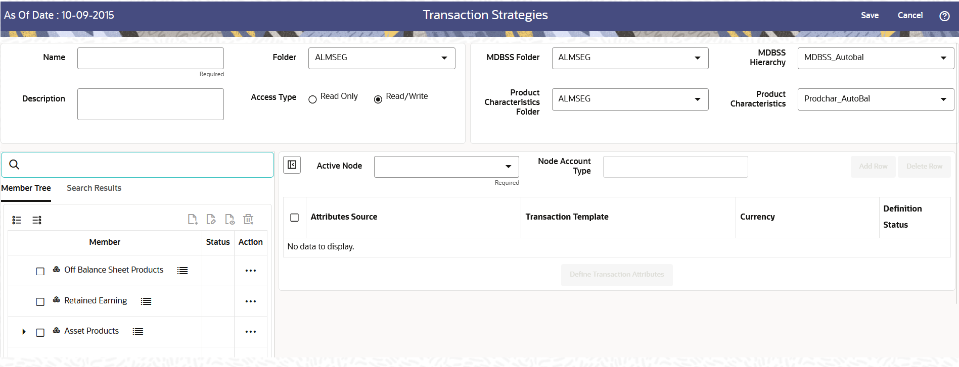

5.3.3.7.1 Create Transaction Strategy Rules
You create a Transaction Strategy Rule to define Transaction Strategy assumptions.
To create a new Transaction Strategy Rule, follow these steps:
- Click Add icon from the top of the Transaction Strategy Rule
Summary page. The Transaction Strategies window is displayed:
Figure 5-220 Transaction Strategy Rule
- Enter the following Details.
- Name: Enter the name of the Transaction Strategy Rule.
- Description (optional): Enter the description of the Transaction Strategy Rule.
- Folder: Select the Folder where the Transaction Strategy Rule needs to be saved.
- Access Type: Select the Access Type as Read-Only or Read/Write.
- Select a MDBSS Folder and MDBSS.
- Select Product Characteristics Folder and Product Characteristics.
- Select MDBSS Node(s) from Member Tree of Assumption Browser. The
Assumption Browser has following two tabs: Member Tree and Search Results.

- Member Tree: Member Tree tab shows the hierarchical structure
and allows you to define rules by selecting the node members from the
browser. Select Node and Click Menu icon next to it to view the available
options.
Figure 5-221 Member Tree
Status of node is also displayed in Member Tree section, for example Selected, and so on. To select member hierarchy, following options are available:
- Expand self, child and descendants: Allows to expand the selected node itself along with its child and descendants.
- Expand selected member/branch: Allows to expand the selected node
- Select UnSelect self, child: Allows to unselect the selected node itself along with its child
- Select UnSelect self, child and descendants: Allows to unselect the selected node itself along with its child and descendants.
- Select Defined self, child: Allows to select the selected node itself along with its child.
- Select Defined self, child and descendants: Allows to select the selected node itself along with its child and descendants.
- UnSelect self, child and descendants: Allows to unselect the selected node itself along with its child and descendants.
Use Show Numeric Code Values (Left) icon to view the code value left to the Node name.
Use Show Numeric Code Values (Right) icon to view the code value right to the Node name.
