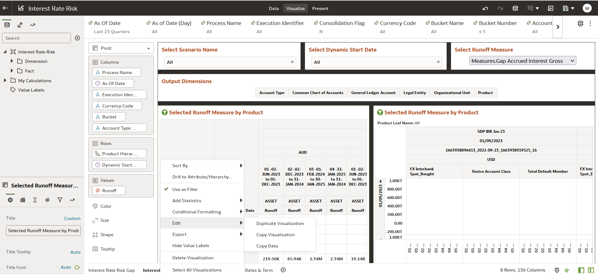

Example:
- Navigate to Interest Rate Risk report and click Interest Rate Risk Runoff.
- Right click on the dimension and select Edit.
- Select Duplicate Visualization.
Figure 7-271 Duplicate Visualization
A copy of the report is created.

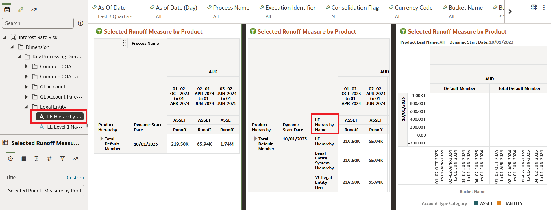

- Click on the Rows to view the dimension.
- Navigate to Dimensions under Interest Rate Report
- Select the dimension type and column name.
- The report will be displayed based on the selected dimension. The new
report is displayed based on selected the dimension.
