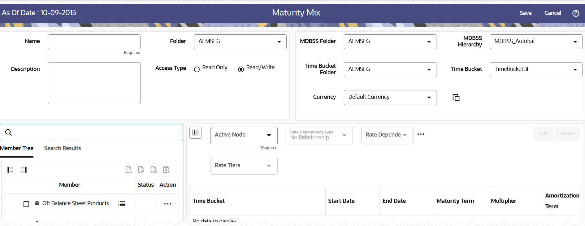

5.3.3.5.1 Creating Maturity Mix Rules
You create Maturity Mix Rules to define the maturity and amortization term for new business volumes. Maturity Mix Rules use the modeling period defined in the Active Time Bucket Rule to set up the date range over which these assumptions can be defined.
Maturity Mix is an optional rule and the default maturity is given in the node’s Product Characteristics.
To create a new Maturity Mix Rule, follow these steps:
Figure 5-207 Maturity Mix Page
Maturity Mix Page
  1. Click the Add icon from the top of the Maturity Mix Summary Page.
  2. Enter the following Details.
    Table 5-47 Create Maturity Mix Rule
    Fields Description
    Name Enter the name of the Maturity Mix rule.
    Description Enter the description of the Maturity Mix rule. This is an optional field.
    Folder Select the Folder where the Maturity Mix rule needs to be saved.
    Access Type Select the Access Type as Read-Only or Read/Write.
    MDBSS Folder Select the MDBSS folder
    MDBSS Hierarchy Select the MDBSS hierarchy
    Time Bucket Folder Select the Folder from which you want to apply Time Bucket rule.
    Time Bucket Select the time horizon/aggregation for process
    Currency Select the currency for the Maturity Mix rule
    If any member is a currency in the MDBSS hierarchy (for example, INR) and selected currency is different (for example, USD), then the member and its children nodes can not be defined.
