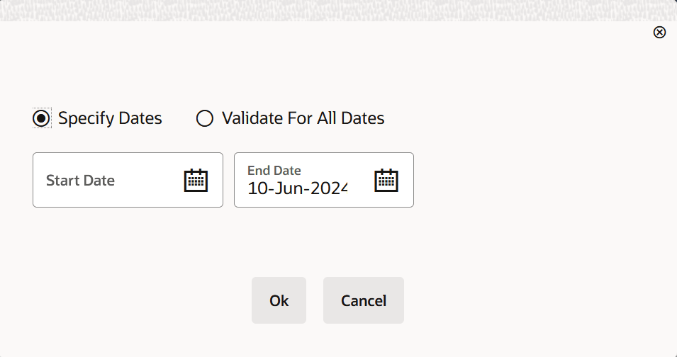

Running an Exchange Rate Validation
You can run a validation immediately or schedule one or more for later. The Validation Status is displayed in the Currency Rates window.
You can execute the Exchange Rate validation using the Currency Rates Validation option.
To execute the Exchange Rate Validation, follow these steps:
- Click Currency Rates Validation.
Figure 5-4 Currency Rates Validation
- To execute Exchange Rate validation from the Currency Rates
window, the following options are available:
- Specify Dates: After selecting this option, a Select Dates Pane is displayed to enter or verify the Start Date and End parameters. These dates will be passed to the batch for execution.
- Validate For All Dates: Select this option to validate all the rates irrespective of dates.
- Start Date: This defaults to the date of last rate validation.
- End Date: This defaults to the current date.
This option will replace all of the validated Exchange Rate History and can be a time-consuming process depending on the amount of history available to be processed.
