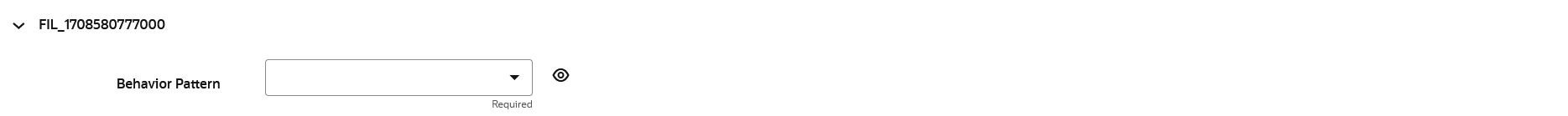

- After defining the conditions, select the Behavior Pattern from
Behavior Pattern drop-down list. Here, the Behavior Pattern drop-down list shows the
list of existing Behavior Patterns.
Figure 5-117 Defining Behavior Pattern Rule
Click below icon to view the details of selected Behavior Pattern.Figure 5-118 View Behavior Pattern
You can select only one Behavior Pattern at a time.
