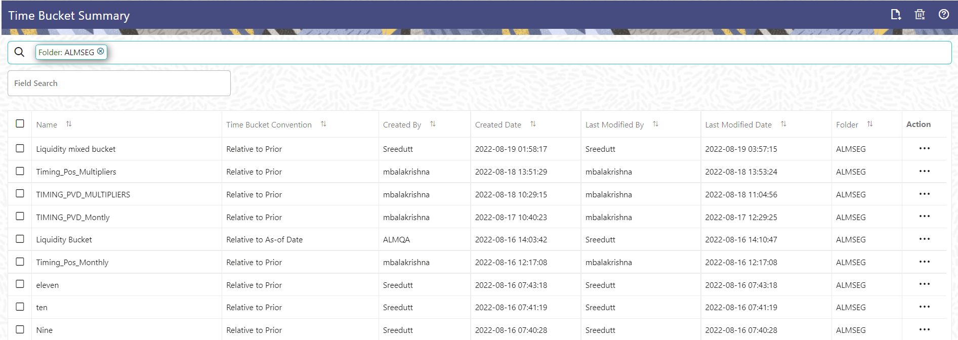

Time Bucket Rule Summary
Search Time Bucket Rule
This page is the gateway to all Time Bucket Rules and related functionality. You can navigate to other pages relating to Time Bucket Rules from this point.
Figure 5-123 Time Bucket Summary
Time Bucket Summary
Prerequisites: Predefined Time Bucket Rule
To search for a Time Bucket Rule:
Click Search after entering the search criteria. The search results are displayed in a table containing all the Time Bucket Rules that meet the search criteria.
Or
An alternative method to search a Time Bucket Rule is through the Field Search option. This is an inline wildcard UI search that allows you to enter a search value (such as code, name, etc.) partially or fully. Rows that contain the string you are searching for are fetched and displayed in the Time Bucket Rule Summary. You can enter the Code, Name, Description, and Folder of the Time Bucket Rule and click Search.
The Time Bucket Rule Summary displays the following information:
Add: Click the Add icon on the page header to build a new Time Bucket Rule.
Multiple Delete: Enables you to select and delete one or multiple rules in the table simultaneously.
  • Name: The Time Bucket Rule's short name.
  • Time Bucket Convention: The Time Bucket Convention.
  • Created By: The Name of the user who created the Time Bucket.
  • Created Date: The Date and Time at which the Time Bucket was created.
  • Last Modified By: The user who last modified the Time Bucket Rule.
  • Last Modified Date: The Date and Time when the Time Bucket Rule was last modified.
  • Folder: The Folder where the Time Bucket Rule is saved.
  • Action: Click this icon to view a list of actions that you can perform on the Time Bucket Rule.
    • View/Edit: Based on the user privilege assigned, you can either only view or edit existing Time Bucket Rules. To edit a rule, you must have Read/Write privilege.
    • Save As: You can reuse a Time Bucket Rule by saving it under a new name thus saving time and effort in entering data multiple times; it also leads to reduced data entry errors.
    • Delete: You can delete Time Bucket Rules that you no longer require. Note that only Time Bucket Rule owners and those with Read/Write privileges can delete Time Bucket Rules. A Time Bucket Rule that has a dependency cannot be deleted. A rule cannot be retrieved after deletion.
    • Dependency Check: You can perform a dependency check to know where a particular Time Bucket Rule has been used. Before deleting a rule, it is always a good practice to do a dependency check to ensure you are not deleting Time Bucket Rules that have dependencies. A report of all rules that utilize the selected Time Bucket Rule is generated.
