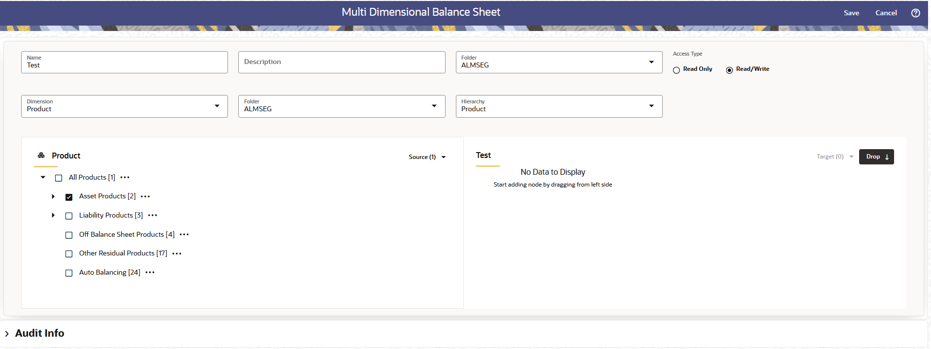

Figure 6-18 MDBSS Rule

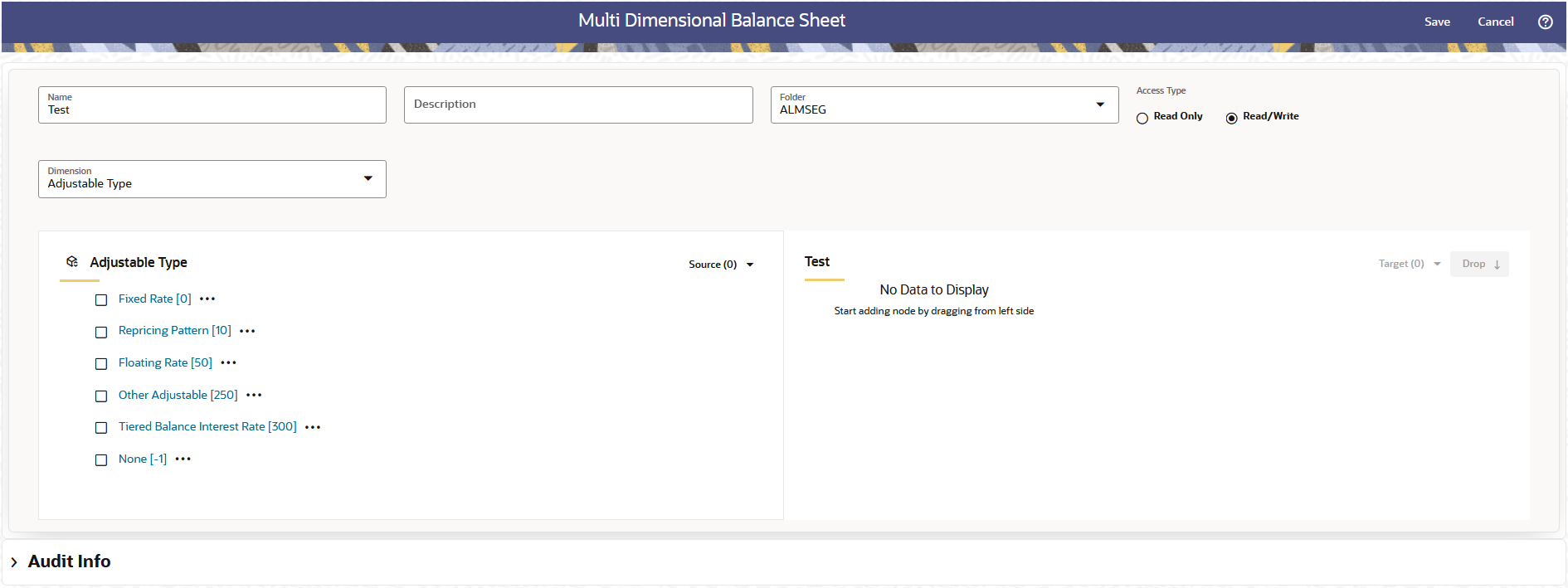

- If Dimension is selected as “Adjustable Type”, then only list of
Adjustable Types will be available.
Figure 6-19 MDBSS Rule
- If Dimension is selected as “Product”, then Product Folder and
Product Hierarchy fields will be available.
- Select the Source of Dimension from Dimension drop-down list. You can click Source option to Select All or Unselect All.
- Select the Target Node of Dimension. Here, You can select more than one Nodes at a time.
- Click Drop. You can use Revert option to reverse the selection.
- Click Target option to Select

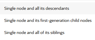

- When you select a Node from Source section, then following
options are available:
Figure 6-20 MDBSS Rule
- Single node and all its descendants: Allows to select node itself along with its descendants.
- Single node and its first-generation child nodes: Allows to select node itself along with its child nodes
- Single node and all of its siblings: Allows to select node itself along with its siblings nodes

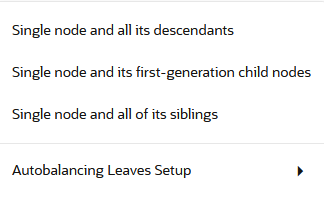

- When node is moved to Target section, then following options are
available:
Figure 6-21 MDBSS Rule
- Autobalancing Leaves Setup: Allows you to setup the Autobalancing for selected node as Asset, Liability, or Retained Earning.
