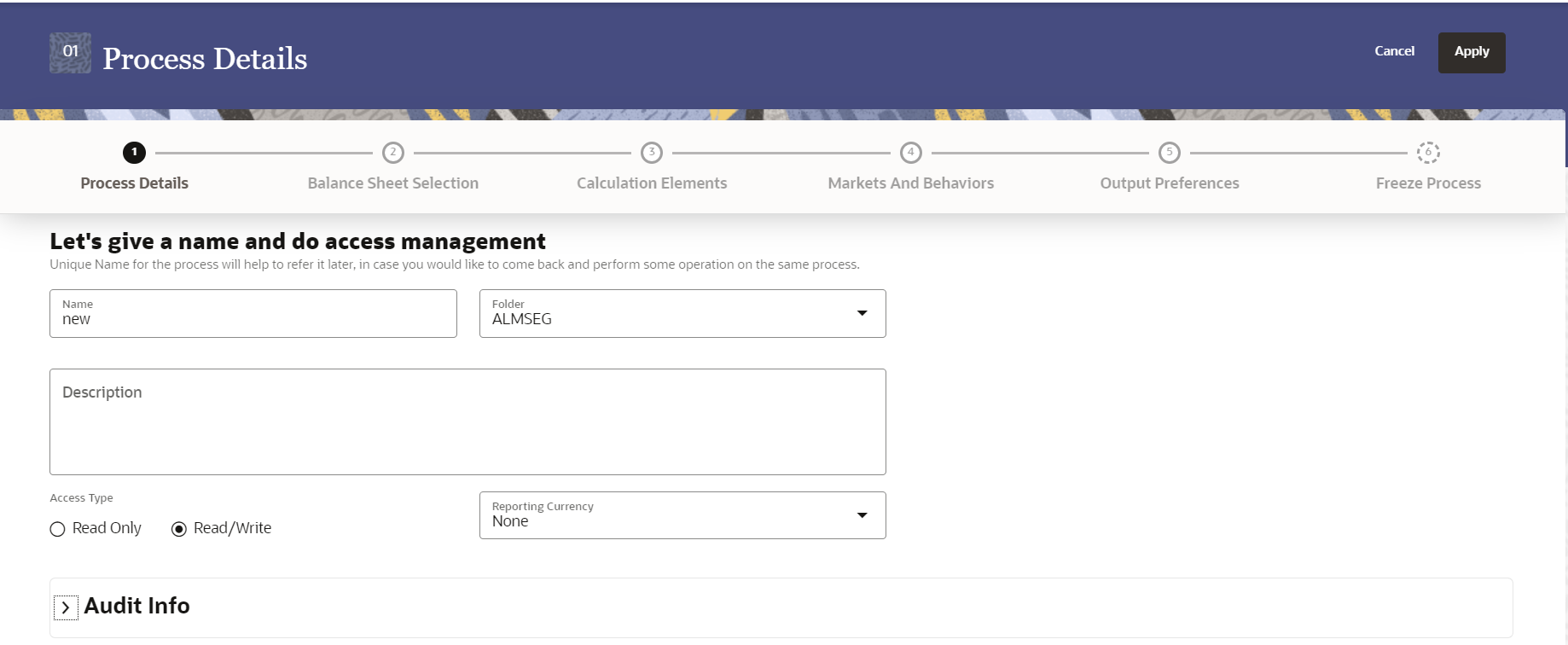

To create a new Static Deterministic Process, perform the following steps:
  1. Navigate to the Static Deterministic Process Summary page.
  2. Click Add . The Create Static Deterministic Process page is displayed.
  3. Enter the details in the Process Details section.
    Figure 6-234 Static Deterministic Process
    Table 6-68 List of process details used for Creating Static Deterministic Process
    Parameter Description
    Name Enter the name of the Static Deterministic Process.
    Folder Select the Folder where the Static Deterministic Process needs to be saved.
    Description Enter the description of the Static Deterministic Process.
    Access Type Select the Access Type as Read-Only or Read/Write.
    Reporting Currency Select the currency for consolidation of results
    Currency Provider This field will be active once you select Reporting Currency. This is used to pick up the exchange rates for consolidation. In SaaS, multiple exchange rate for same currency pair can be stored, sourced from different rate providers. By default, member name “Missing” is displayed here. Values can be added to dimension ‘Rate Data Source’ and used in Currency Rates UI. The defined data will appear in the ALM Process UI and one of them can be selected.

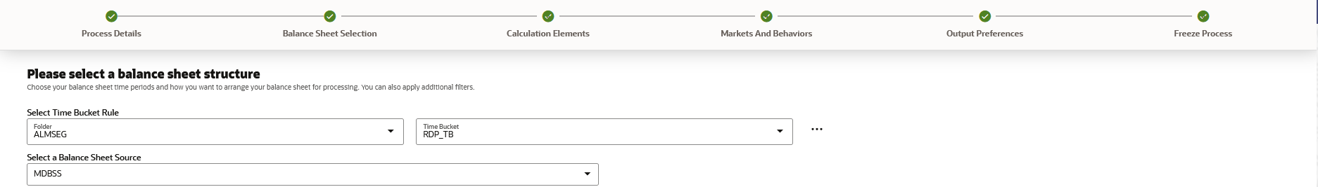

  4. Click Apply to navigate to the Balance Sheet Selection section.
    Figure 6-235 Balance Sheet Selection
  5. Enter the Balance Sheet Structure details as shown in the following table:
    Table 6-69 List of Balance Sheet Structure details used for Creating Static Deterministic Process
    Time Bucket Rule Folder Select the Folder from which you want to apply Time Bucket Rule.
    Time Bucket Rule Select the time horizon/aggregation for process. Also, following options are available when you click Action button next to Time Bucket field.
    Figure 6-236 Time Bucket
    Time Bucket
    Balance Sheet Source Select the Balance Sheet Source as MDBSS, Hierarchy or Data Table from Balance Sheet Source drop-down list.
    After selecting the Balance Sheet Source, Source details block is activated.

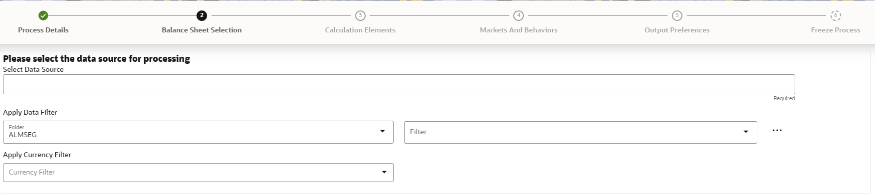

    • If Balance Sheet Source is selected as Data Table, then following fields are available:
      Figure 6-237 Data Source details of Balance Sheet Selection
      Enter the Data Source details of Balance Sheet.
      Table 6-70 Data Source details used for Creating Static Deterministic Process
      Data Source This field allows you to select the Instrument tables that must be included in a Static Deterministic Process. For example, Asset, Derivative, and so on.
      Data Filter Folder Select the Folder from which you want to apply Data Filter.
      Data Filter This field allows you to select a subset of data for processing by selecting a filter. You can select a filter that was previously created, or define a new filter on the fly.
      Currency Filter Optionally apply a currency filter on the selected data.

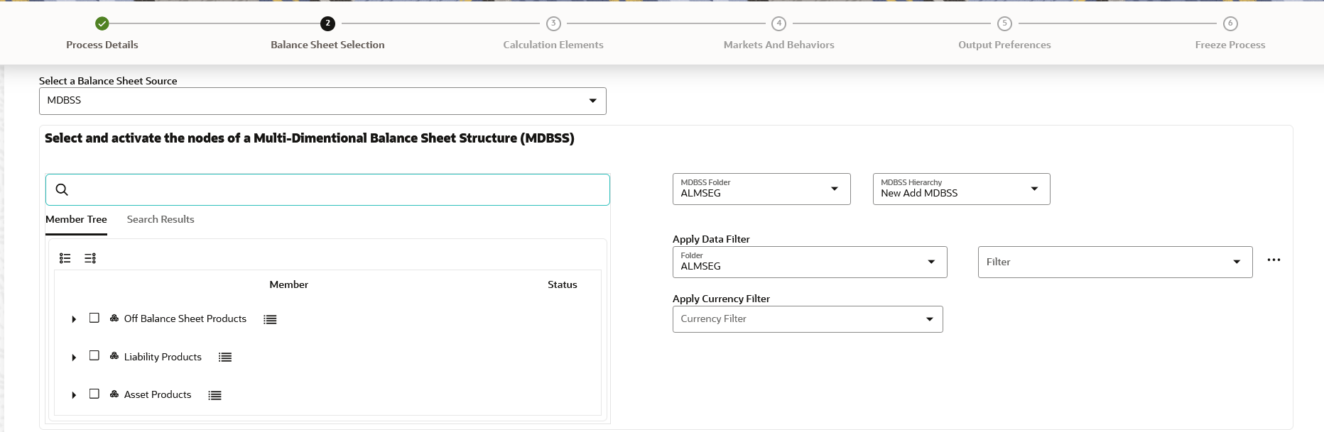

    • If Balance Sheet Source is selected as MDBSS, then following fields are available:
      Figure 6-238 MDBSS details
      MDBSS details
      Enter the MDBSS details.
      Table 6-71 MDBSS Details
      Member Tree This shows the hierarchical structure and allows you to define rules by selecting the node members from the browser. Select Node and Click Menu icon next to it to view the available options.
      Figure 6-239 Member Tree Selection
      Status of node is also displayed in Member Tree section, for example Selected, and so on. To select member hierarchy, following options are available:

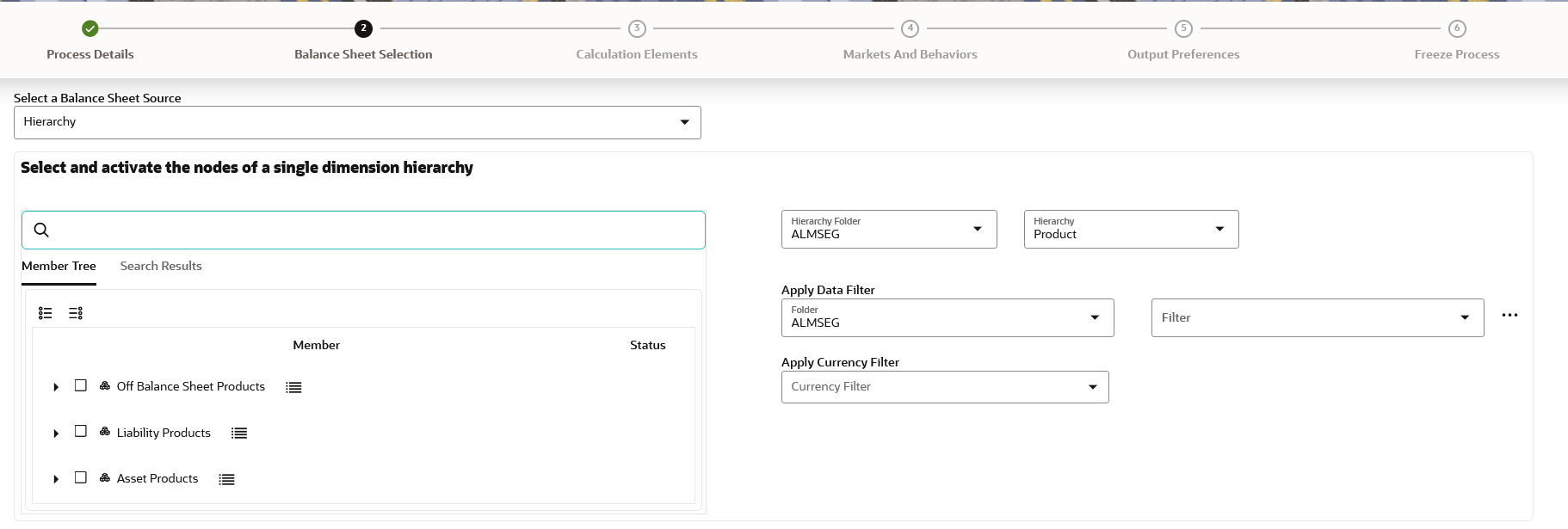

    • If Balance Sheet Source is selected as Hierarchy, then following fields are available:
      Figure 6-242 Product Hierarchy details
      Enter the Product details of Balance Sheet.
      Table 6-72 Product Details
      Figure 6-243 Member Tree Selection

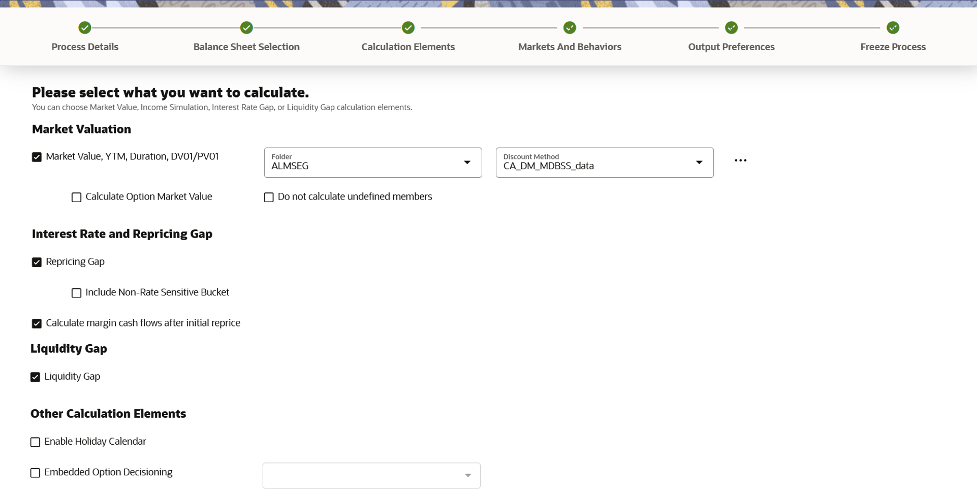

  6. Click Apply to navigate to the Calculation Elements section.
    Figure 6-246 Calculation Elements
  7. Enter the Calculation Elements details as shown in the following table:
    Table 6-73 List of Calculation Elements details used for Creating Static Deterministic Process
    Market Valuation Select the Market Value, YTM, Duration, DV01/PV01 option if you want to perform present value (MV) calculations. Discount method is required. You can select from predefined rules, or create one on the fly.
    Discount Method Folder Select the folder from where discount rules are saved.
    Discount Method Select Discount Method you want to be applied to the process. refer to Discount Method section to set up Discount Method Rules.
    Also, following options are available when you click Action button next to Discount Method.
    Figure 6-247 Discount Method
    Discount Method
    Calculate Option Market Value The Calculate Option Market Value option is used to calculate the Market Valuation (MV) for certain embedded and stand-alone (bare) options. Supported embedded options are Calls, Puts, Caps (caplets) and Floors (floorlets). This option will be enabled only if Market Value, YTM, Duration, DV01/PV01 option is also selected.
    For example, When Calculate Option Market Value check-box is selected and RATE_CAP_LIFE has data filled (that is, holds a non-null value greater than 0), then Embedded CAP Option MV will be calculated.
    When Calculate Option Market Value check box is selected and RATE_FLOOR_LIFE has data filled (that is, it is non-null value greater than 0 or it is less than RATE_CAP_LIFE and RATE_CAP_LIFE is greater than 0), then Embedded FLOOR Option MV will be calculated.
    Do not Calculate undefined members Enable this option, if undefined members are not required in calculation.
    Repricing Gap Select Repricing Gap check-box if you want to include Interest Rate gap risk measures. Note, this requires a time bucket with IR Gap buckets defined.
    Include Non- Rate Sensitive Bucket
    Include Non Rate Sensitive Bucket check-box gets enabled when ‘Repricing Gap’ is selected. The Attribute of product dimension ‘Interest Rate Sensitivity Category’ identifies products as Interest Rate sensitive or Non Interest Rate sensitive. Once ‘Include Non Rate Sensitive Bucket’ is enabled, reprice gap output of Products which are mapped as Non Interest Rate sensitive, would move into Non Interest Rate Sensitive bucket.
    For more information on Non Interest Rate Sensitive Bucket, see Time Buckets. If ‘Include Non Rate Sensitive Bucket’ is not enabled, engine will ignore ‘Interest Rate Sensitivity Category’ product attribute, and would treat all products as Interest Rate Sensitive. Reprice Gap output would move into respective Reprice Gap buckets.
    Calculate Margin Cash Flow After Initial Reprice If 'Calculate Margin cashflows as After Initial Reprice' is enabled, the engine will use the margin of adjustable rate instruments to continue generating interest cash flows after a gap repricing event up until total runoff occurs.
    Liquidity Gap Select the Liquidity Gap if you want to include liquidity gap risk measures. Note, this requires a time bucket with LR gap buckets defined.
    Enable Holiday Calendar If you enable Holiday Calendar cash flow dates falling on a holiday, it gets adjusted as per defined conventions. Holiday calendar criteria is defined on the instruments.
    Embedded Option Decisioning If your processed data contains fixed rate bonds with embedded options, you can select the behavior of the option to force it to maturity of the instrument, force it to first option expiry date, or let it be rate path dependent.
    This drop-down has following options:
    Figure 6-248 Embedded Option Decisioning

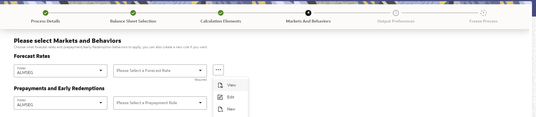

  8. Click Apply to navigate to the Markets and Behaviors section.
    Figure 6-249 Markets and Behaviors
  9. Enter the Calculation Elements details as shown in the following table:
    Table 6-74 List of Market and Behavior details used for Creating Static Deterministic Process
    Forecast Rates Select the Folder and Forecast Rates Rule you want to be applied to the process. See Forecast Rate Scenarios to define rate scenarios.
    Figure 6-250 Forecast Rates
    Forecast Rates
    Prepayment Rules and Early Redemptions Select the Folder and Prepayment Rule you want to be applied during cash flow calculation. See Prepayment, to set up Prepayment Methods. This is an optional step.
    Figure 6-251 Prepayment Rules
    Prepayment Rules

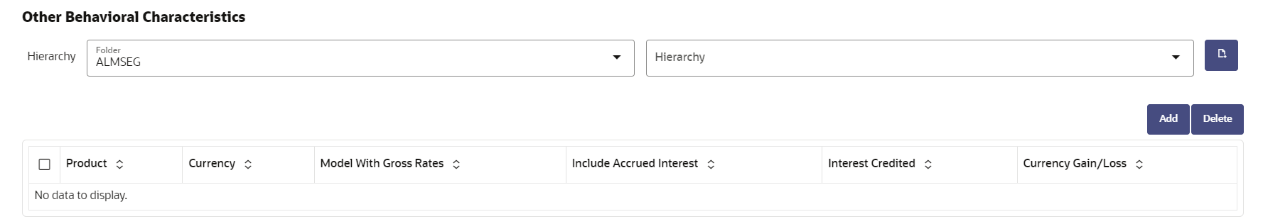

  10. Enter the following details in Other Behavioral Characteristics sub-section of Market and Behaviors section.
    Figure 6-252 Other Behavioral Characteristics
    Table 6-75 Product Characteristics details used for Creating Static Deterministic Process
    Product Hierarchy Folder
    You can specify additional processing parameters at a product-currency level.
    Select the Folder from the Product Hierarchy Folder list.
    Product Hierarchy
    Select the Product Hierarchy on which you want to specify parameters. To add a Product Hierarchy, follow these steps:
    1. Click Open Hierarchy Browser button next to the Hierarchy field.
    2. Select one or more products using the corresponding check-box and click Done.
  11. After clicking Add, the list of product is displayed with the following details:
    Table 6-76 Product details used for Creating Static Deterministic Process
    Product Shows the selected product details.
    Currency Shows the currency of the selected product.
    Interest Credited Yes or No status of Interest Credited. This option shows the interest payments to be capitalized as principal on simple or non-amortizing instruments.
    Model With Gross Rates If the institution has outsourced loan serving rights for some of the assets (most typically mortgages), the rates paid by customers on those assets (gross rates) are greater than the rates received by the bank (net rates). For these instruments, both a net and gross rate is calculated within the cash flow engine and both gross and net rate financial elements are the output. The gross rate is used for prepayment and amortization calculations. The net rate is used for income simulation and the calculation of retained earnings in the auto-balancing process.

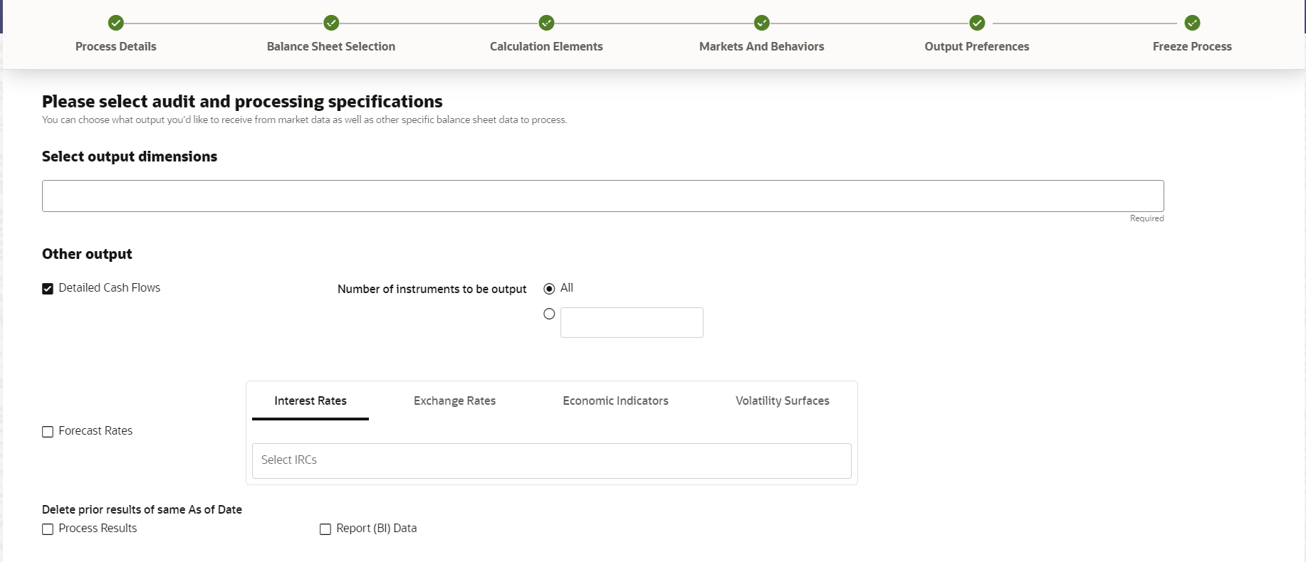

    Figure 6-253 Output Preferences
    Output Preferences
  13. Enter the Output Preferences details shown in the following table.
    Table 6-77 List of Output Preferences details used for Creating Static Deterministic Process
    Output Dimensions Shows the list of dimensions. You can select up to 10 dimensions for aggregation. Currency and Account Type are part of output by default.
    It is applicable when Balance Sheet Source is selected as Data Table or Hierarchy.
    Detailed Cash Flow
    Check the box to record the instrument detail cash flows occurring for the desired number of records processed. For each record, daily cashflow and market value results are written to the FSI_ALM_CASHFLOW_OUTPUT_HIST and FSI_ALM_CASHFLOW_DYN_MV_OUTPUT_HIST tables.
    Select the desired number of Records in the dialog box or select all records to be output.
    The number of records output directly impact processing time. It is recommend to use this as an audit function only, with few records chosen.
    Forecast Interest Rates Select the Interest Rate Curves for which you want the engine to write forecasted interest rates in the database table.
    Forecast Exchange Rate Select the Exchange Rates for which you want the engine to write forecasted exchange rates in the database table.
    Forecast Economic Indicators Select the Economic Indicators for which you want the engine to write forecasted interest rates in the database table.
    Volatility Surface Select the Volatility Surfaces for which you want the engine to write forecasted Volatility Surface in the database table.
    Delete prior results of same As of Date
    • Process Results: If this check-box is selected, then engine removes the results of previous process execution ID and As of Date. Engine fetches all the details of the same Process ID and As Of Date from the tables. Process history tables keep track of execution id's whose data has been deleted.
    • Report (BI) Data: If this check-box is selected, then engine moves the results of previous process to BI report before removing the results of previous process execution ID and As of Date.
    Currency and Account Type are part of output by default. Dimensions like product, Org unit, etc can be selected to aggregate results.
    The consolidation is done by default if the reporting currency is selected in Process Details.

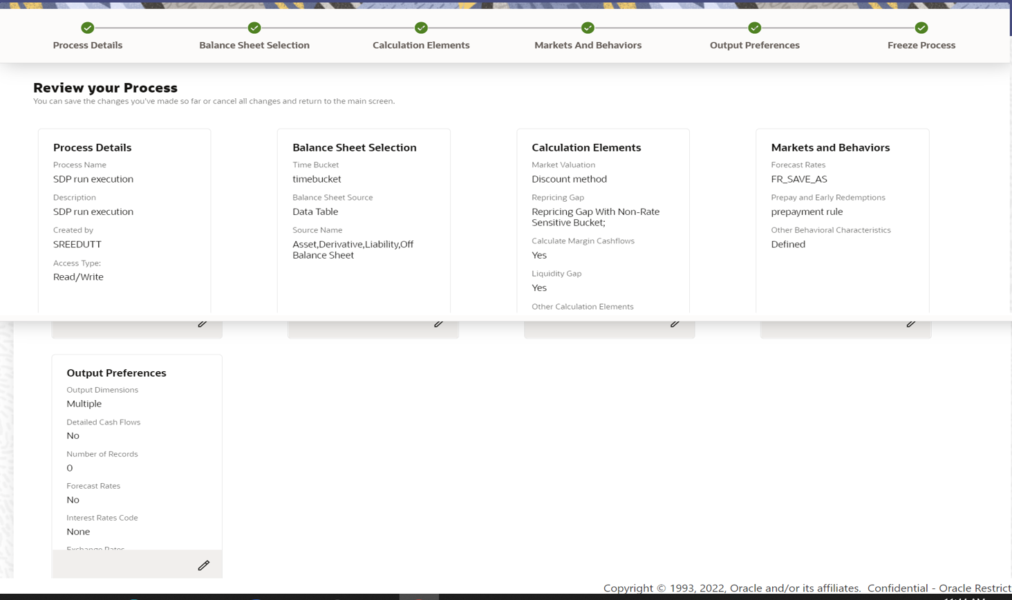

  14. Click Apply to navigate to the Freeze Process section.
    Figure 6-254 Freeze Process
    Freeze Process
  15. Verify the changes and click Save.
