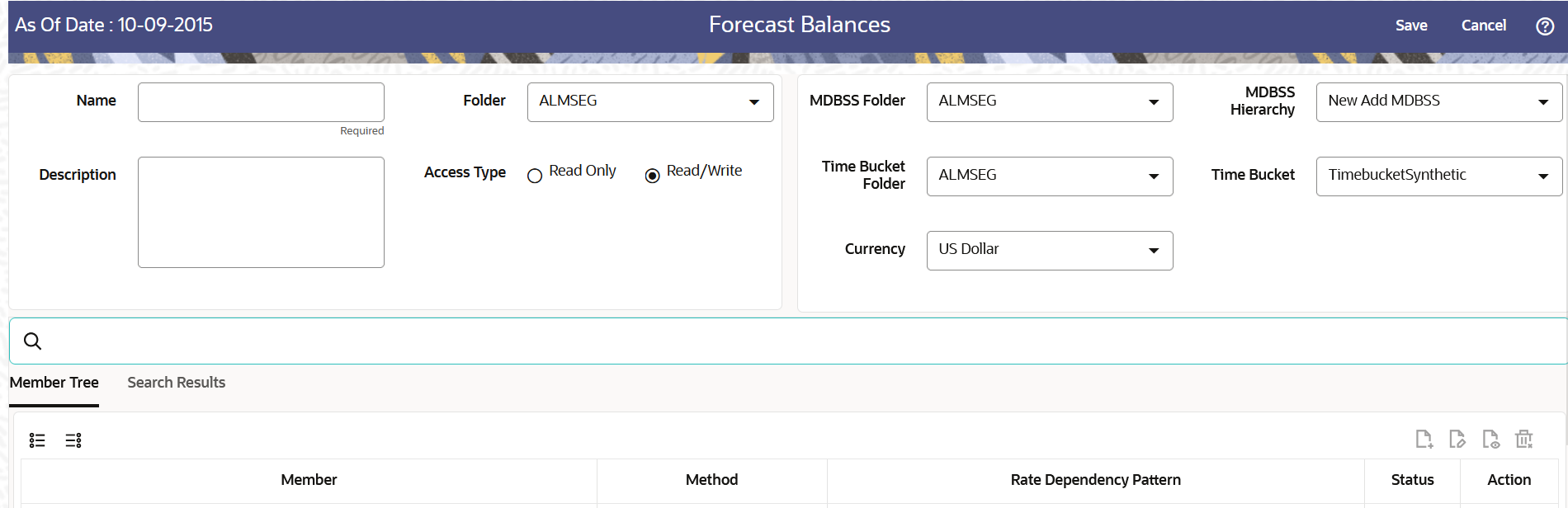

6.3.3.2.2 Creating a Forecast Balance Rule
To create a new Forecast Balance rule, complete the following steps:
Figure 6-151 Create Forecast Balance Rule
- Click the Add on the Forecast Balances summary page to add a new rule.
- Enter the following Details.
Table 6-44 Create Forecast Balance Rule
Fields Description Name Enter the name of the Forecast Balance Rule. Description Enter the description of the Forecast Balance Rule. This is an optional field. Folder Select the Folder where the Forecast Balance Rule needs to be saved. Access Type Select the Access Type as Read-Only or Read/Write. MDBSS Folder Select the MDBSS folder MDBSS Hierarchy Select the MDBSS hierarchy Time Bucket Folder Select the Folder from which you want to apply Time Bucket Rule. Time Bucket Rule Select the time horizon/aggregation for rule. Assumptions that you define when creating a forecast balance are based on a specific modeling horizon, which is defined in the Time Buckets. Example

- Select the MDBSS node(s) from Assumption Browser. The Assumption Browser
has following two tabs: Member Tree and Search Results
