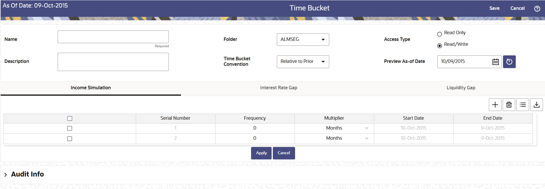

  1. Navigate to the Time Buckets Summary page.
  2. Click Add to create a new Time Bucket Rule.
    Figure 6-119 Creating Time Bucket Rule
  3. Enter the Name and Description of Time Bucket.
  4. Select the Folder and Access Type.
  5. Select Time Bucket Convention as Relative to Prior or Relative to As-of Date option.

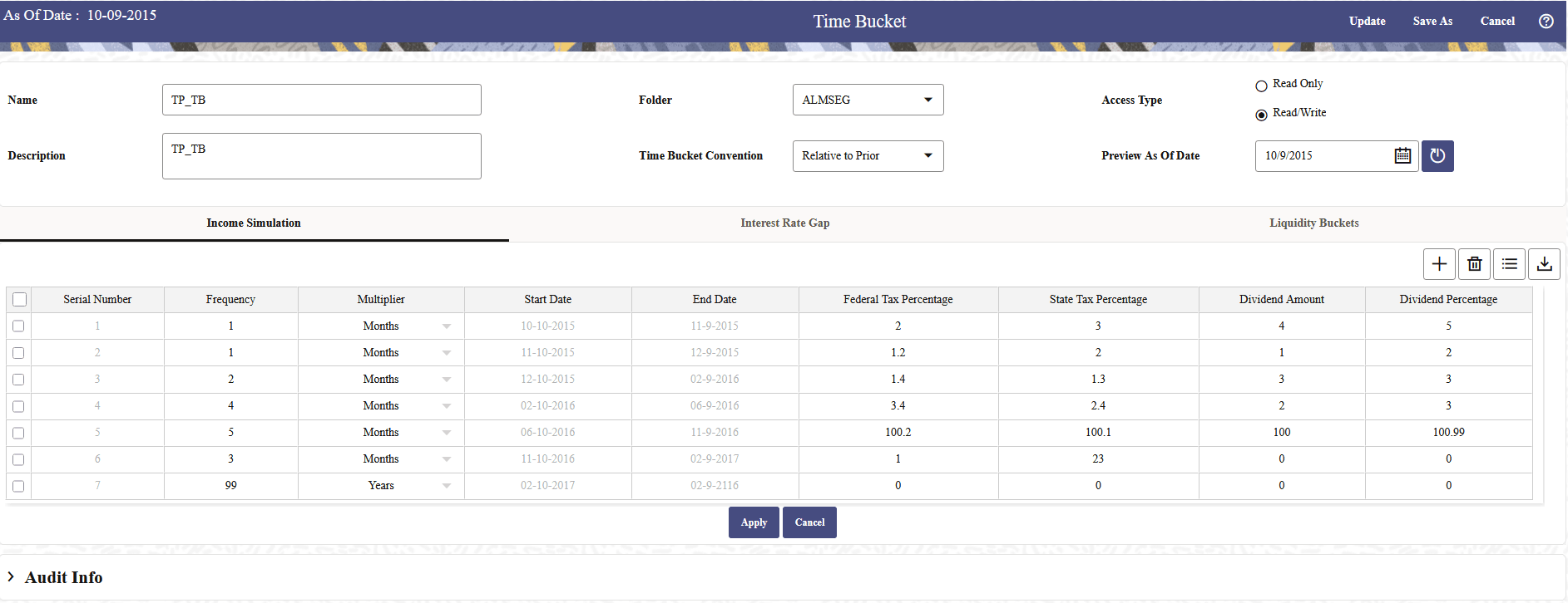

  7. You can Preview As-of Date by using Preview As-of Date option.
  8. Define the Time Bucket Rule. For more information, see Defining Time Bucket Rules
