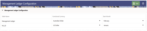

    Figure 6-61 Management Ledger Configuration
    This screen allows you to input the Management Ledger Configuration for Profitability Management Cloud Service.
  2. Select the following details:
