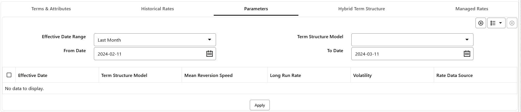

To define the Parameter Estimation, follow these steps:
  1. Navigate to Parameters tab of Interest Rate Curve.
    Figure 6-11 Parameters Tab on Interest Rate Curve window
  2. Enter the Effective Date Range filter.
  3. After clicking Add, default parameters for the Extended Vasicek Model are displayed for one Effective Date (the System Date on which the Interest Rate Code was created). You can edit these parameters or add new parameters using Add.
  4. Enter the Effective Date. Note that the Effective Date cannot be greater than the Current System Date.
  5. Select the Model from the Term Structure Model drop-down list. Effective Date and Term Structure Model combination must be unique within this IRC.
