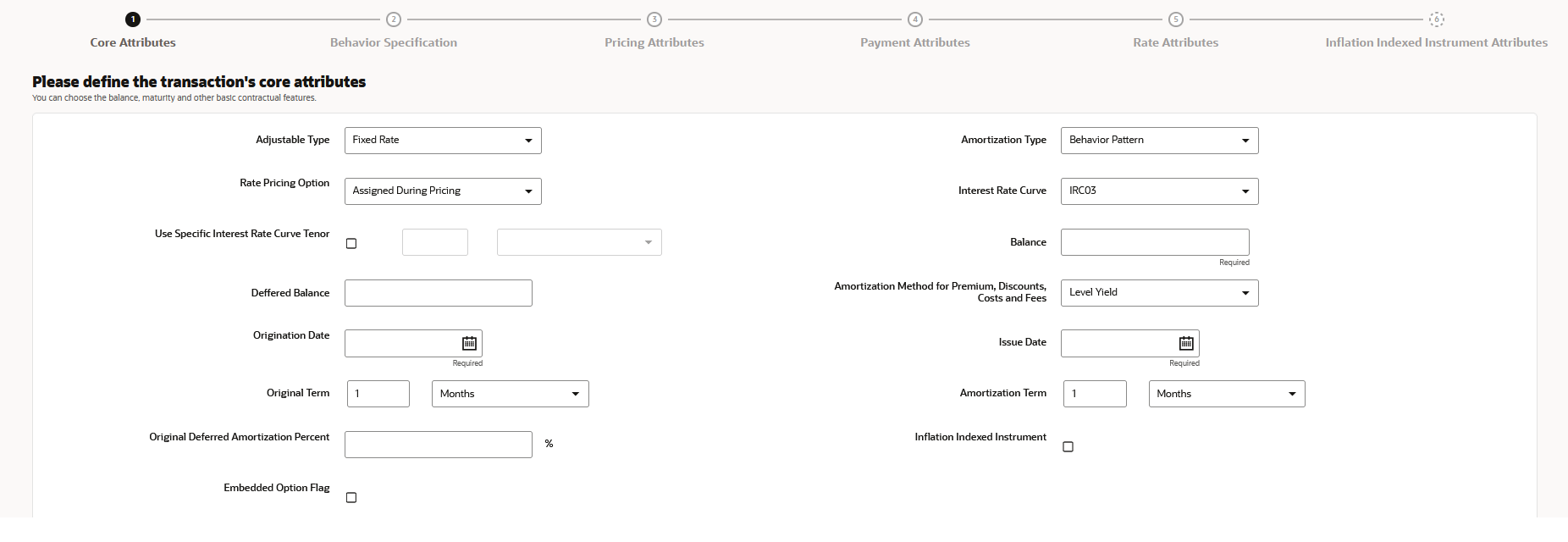

Core Attributes
This section describes the new business fields used in the Core Attributes section of the Transaction Strategy Rule.
Figure 6-217 Core Attributes
Table 6-53 Fields to add the Core Attributes for Transaction Strategy Rule and their Descriptions
| Field | Description |
Adjustable Type |
Determines the repricing characteristics of the new business record. The standard OFSAA codes are as follows: Fixed-Rate Floating Rate Other Adjustable Repricing Pattern Tired Balance Interest Rate |
| Amortization Type |
Method of amortizing principal and interest. The choices consist of all standard OFSAA codes and all additional user-defined codes created through the Payment Pattern and Behavior Pattern interfaces, as follows: Figure 6-218 Amortization Type ![]() |
| Rate Pricing Option | This drop-down list has following two Rate Pricing
options:
Direct Input: This option allows you to input rates for new business in the Transaction Strategy. Assign During Processing: This option uses the Origination Date and Interest Rate Code (IRC) specified in the Transaction Strategy and pulls the corresponding rate from the Forecast Rates Assumption, that is, it is priced dynamically during the simulation |
Interest Rate Curve |
Defines the pricing index to which the instrument interest rate is contractually tied. The interest rate codes that appear as a selection option depending on the choice of currency. The interest rate code list is restricted to codes that have the selected currency as the Reference Currency. If the default currency is chosen, all interest rate codes are available as a selection. |
| Use Specific Interest Rate Curve Tenor | Allows you to select a specific Interest Rate Curve Tenor |
| Balance | Enter the Balance Amount. |
| Deferred Balance | Current Unamortized Deferred Balance associated with Instrument (such as, Premium, Discount, Fees, and so on.) |
| Amortization Method for Premiums, Discounts, Costs and Fees |
Determines the method used for amortizing premiums, discounts, or fees. The available codes are: Level Yield Straight Line |
| Origination Date | The date of the origination for the transaction account. This day can be in the future or the past |
| Issue Date | The Issue date for the transaction account. |
| Original Term | The contractual term at origination date in units (days, months, or years). |
| Amortization Term | Term upon which amortization is based in units (days, months, years). This field is not editable if the Derivative Type is selected as FX Contract and subtype is selected as Spot or Forward |
| Original Deferred Amortization Percent | The initial deferred balance expressed as a percent of original par balance. |
| Inflation Indexed Instrument | Select this check box to enable the Inflation Indexed tab |

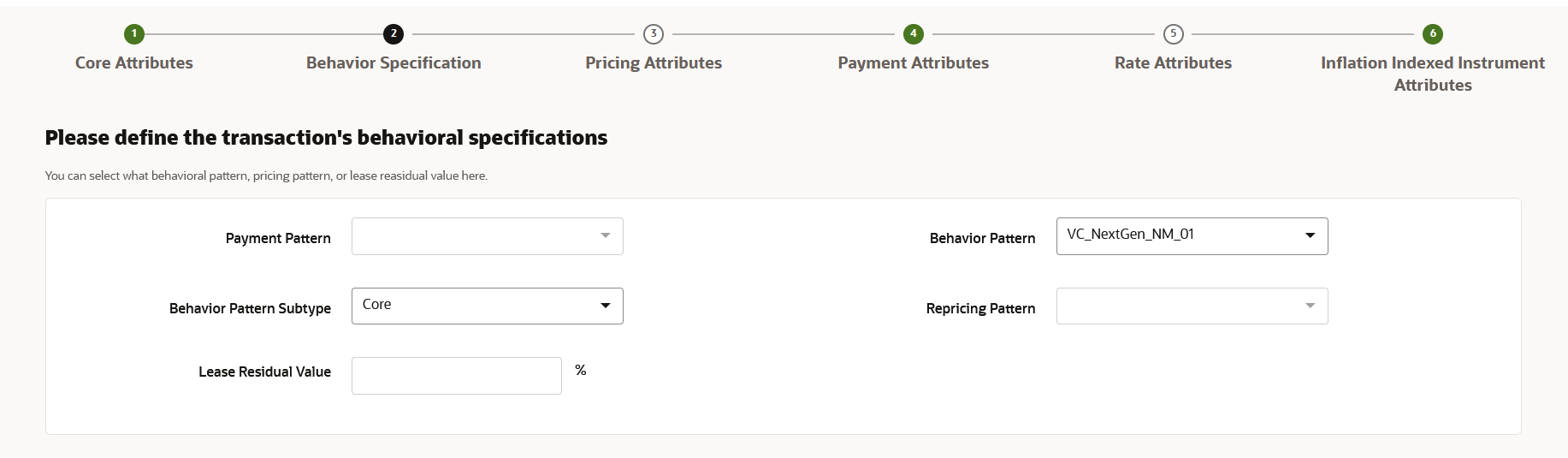

Behavior Specification
This section describes the new business fields used in the Behavior Specification section of the Transaction Strategy Rule.
Figure 6-219 Behavior Specification
Table 6-54 Fields to add the Behavior Specification and their Descriptions
| Payment Pattern | Lists all user-defined payment patterns defined through the user interface. |
| Behavior Pattern | Lists all user-defined behavior patterns created through the user interface. |
| Behavior Pattern Subtype | Lists the subtype of user-defined behavior patterns created through the user interface. |
| Repricing Pattern | Lists all user-defined reprice patterns created through the user interface. |
| Lease Residual Value | The residual value of a lease in the percentage of the original balance. |

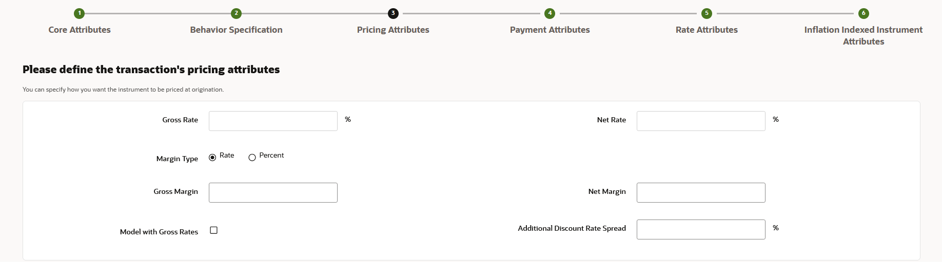

Pricing Attributes
This section describes the new business fields used in the Pricing Attributes section of the Transaction Strategy Rule.
Figure 6-220 Pricing Attributes
Table 6-55 Fields to add the Pricing Attributes for Transaction Strategy Rule and their Descriptions
| Gross Rate | Gross rate on the instrument (such as, paid by the customer). |
| Net Rate | The nominal interest rate on instrument owed to or paid by, the financial institution. |
| Margin Type | The Margin Type can be selected as Rate or
Percentage.
Rate- By default, Rate is selected. This is a fixed spread. Percent- Margin is calculated using the provided margin (as percent) and forecast rate. For example, if the forecast rate is 5% and the margin is 10%, then the margin calculated will be 10% of the forecasted rate. |
Gross Margin |
Contractual spread over interest rate code used in the calculation of the gross rate |
| Net Margin | The contractual margin over the interest rate code used in computing net rate. Gross margin minus any fees. |
| Model with Gross Rates | If the institution has outsourced loan serving rights for some of the assets (most typically mortgages), the rates paid by customers on those assets (gross rates) will be greater than the rates received by the bank (net rates). For these instruments, both a net and gross rate will be calculated within the cash flow engine and both gross and net rate financial elements will be output. The gross rate is used for prepayment and amortization calculations. The net rate is used for income simulation and the calculation of retained earnings in the auto-balancing process |
| Additional Discount Rate Spread | Enter Additional Discount Rate Spread in percentage. |

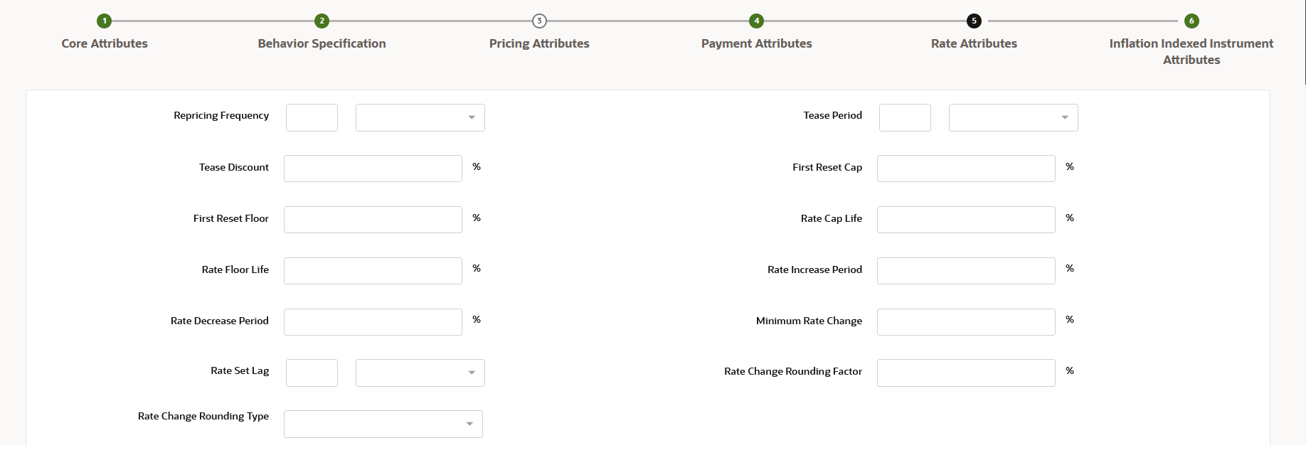

Rate Attributes
This section describes the new business fields used in the Rate Attributes section of the Transaction Strategy Rule.
Figure 6-222 Rate Attributes section
Table 6-57 Fields to add the Rate Attributes for Transaction Strategy Rule and their Descriptions
| Repricing Frequency | Contractual frequency of rate adjustment. |
| Tease Period | The tease period is used to determine the length of the tease period. |
| Tease Discount | The tease discount is used in conjunction with the original rate to calculate the tease rate. The tease rate is the original rate less than the tease discount. |
| First Reset Cap |
This indicates the maximum delta between the initial rate and the first reset for mortgage instruments that have a tease period. This rate will be applicable at the tease end period, before the first reset. After this, the periodic and lifetime cap value will be applied. The value of this field will be automatically populated from the Product Profile window if the product is mapped to Product Profile and value is defined for First Reset Cap. For example: Current Rate = 3.5% (from the instrument record) Margin = 0.3 % First Reset Cap = 0.5% (from the instrument record) First Reset Floor = 0.1% (from the instrument record) Scenario 1: If New Forecasted Rate = 5.1% (Forecast Rates Assumption) The fully indexed rate (after applying minimum rate change, rounding effects) is higher than the (Current Rate + First Reset Cap). So, the new rate assigned will be 3.5% + 0.5% = 4.0% |
| First Reset Floor | This is the initial minimum value for mortgage instruments that have a tease period. This floor rate will be applicable at the tease end period, before the first reset. After this, the periodic and lifetime floor value will be applied. The value of this field will be automatically populated from the Product Profile window if the product is mapped to Product Profile and value is defined for First Reset Floor. |
| Rate Cap Life | The maximum rate for the life of the instrument. |
| Rate Floor Life | The minimum rate for the life of the instrument. |
| Rate Increase Period | The maximum interest rate increase allowed during the cycle on an Adjustable Rate instrument. |
| Rate Decrease Period | The maximum amount rate can decrease during the repricing period of an Adjustable Rate instrument. |
| Minimum Rate Change | The minimum required change in rate on a repricing date. |
| Rate Set Lag | Period by which the rate lookup lags the repricing event date |
| Rate Change Rounding Factor | Percent to which the rate change on an adjustable instrument is rounded. |
| Rate Change Rounding Type |
The method used for rounding of interest rate codes. The choices are as follows:

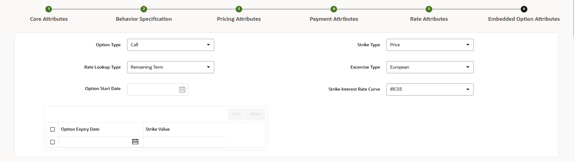

Embedded Option Attributes
An option is a contract between a buyer and a seller in which the buyer has the right, but not the obligation, to purchase (in the case of a call option) or sell (in the case of a put option) a specified underlying asset at a specified price during or at the end of a specified period. The option seller, or writer, grants this right in return for the option price, or premium. The option buyer is long the contract; the seller is short.
Select the Embedded Option Flag check box on the Core Attributes section to enable the Embedded Option Attributes section.
Figure 6-224 Embedded Option Attributes
Table 6-59 Fields to add the Embedded Option attributes and their Descriptions
| Field | Behavior |
| Option Type | This attribute stores the option type of the embedded option. The list of valid values is 1 (Call) and 2 (Put). |
| Strike Type | This attribute stores the strike type code of the embedded option. A strike type of price assumes that the price of the instrument is used as the strike. A strike type of rate assumes that the interest rate of the instrument is used as the strike. The list of valid values is 1 (Price) and 2 (Rate). |
| Rate Lookup Type | This attribute stores the rate lookup code. Depending upon the rate lookup, the rate of the appropriate term is compared against the strike rate. For instance, if the rate lookup code is Payment Frequency, the Strike IRC term point of payment frequency is compared against the strike rate. List of valid values is 1 (Remaining Term), 2 (Original Term), 3 (Payment Frequency), and 4 (Reprice Frequency). |
| Execerise Type | This attribute stores the exercise type code or option style of the embedded option. The list of valid values is 1 (American), 2 (Bermudan), 3 (European). |
| Option Start Date | This attribute stores the options start date and is valid for the American style of options. |
| Strike Interest Rate Curve | This attribute stores the coded value of the interest rate curve which is linked to the strike. |
| Option Expiry Date | This attribute stores the expiry date of the option. |
| Strike Value | This attribute stores the strike rate (for example, entering “3.56” equals 3.56% ) or price (for example, 102.15) depending on the strike type of the option. |
